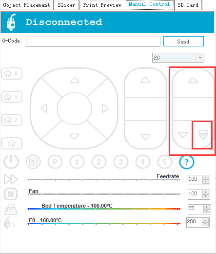

Calibrating the printer with smartto, z axis and thought I would check the extruder.
1. How do you get the printer to extrude 100 mm of filament?
2. Smartto ver 1.0? did not find settings. Tried ver 1.2? And it loaded some settings. The motor steps were in red 000.000 so I just typed the settings in, saved and it worked.
How can I get the rest of the settings to appear?

1.If your slicing software is RepetierHost , as shown in the picture, you can make the extruder extrude 100mm.
2.As for the smartto firmware, you can refer to this link
viewtopic.php?f=20&t=60676&p=82222#p82222
