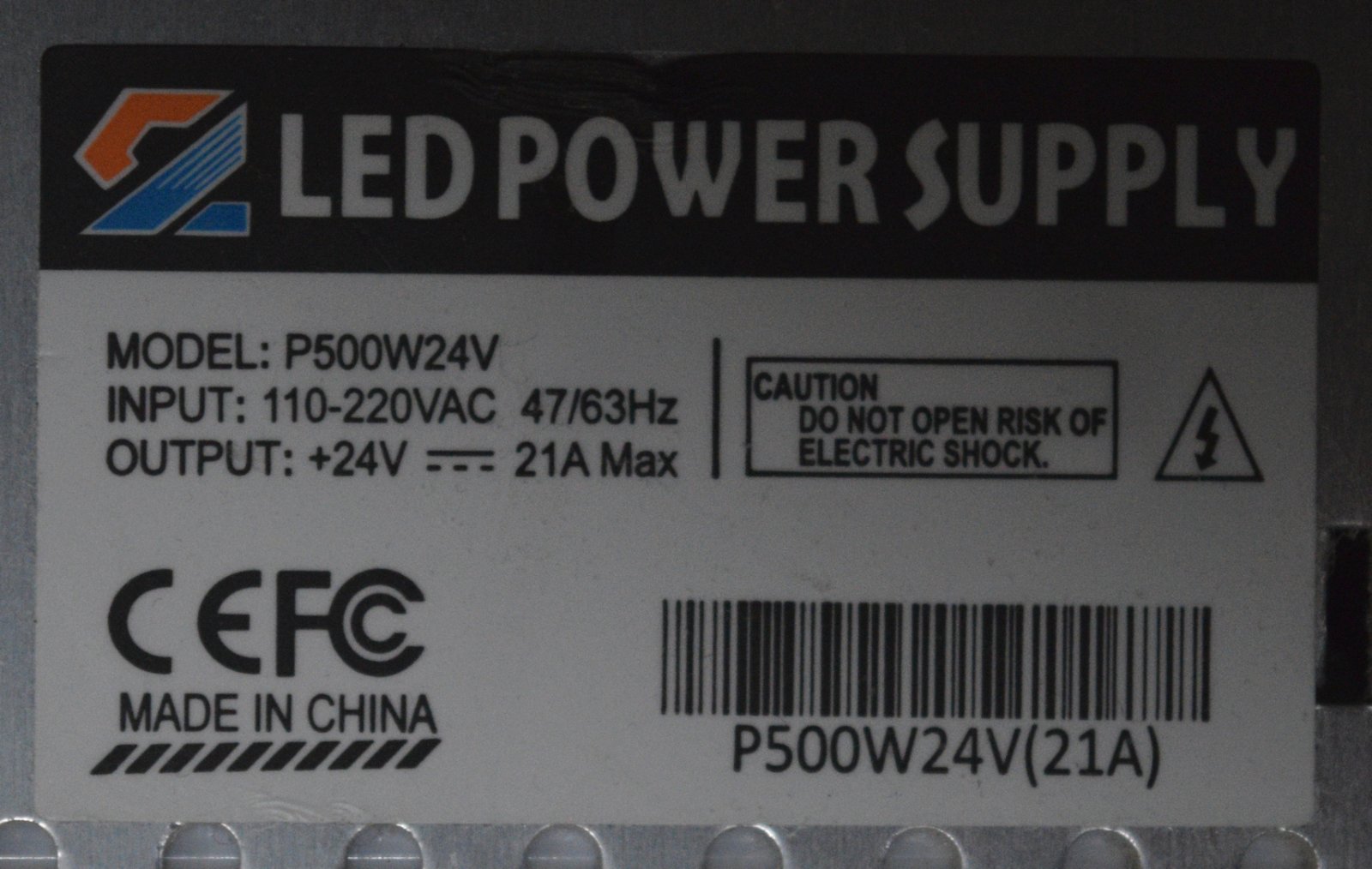

My power supply is a P500W24V so I got the 24V Replacement Bed Kit, But on removing the Hotbed that was on my A30 it is wired for 12V So I am very confused, Will it be ok to put the 24V bed on it or not?
Also The Super Plate that came with the Replacement bed the yellow pealable paper on the back has 2 bad creases on it where the the adhesive hasnt been stuck onto the glass properly So it means I will not have a flat surface The main reason I was replacing the Original bed, Because the Superplate had been stuck down with the Orange Tape still left around the edge of the hotbed which made the Center of the bed lower to the rest, though it is only a small amount I would have problems with prints not sticking to the center of the bed.
Thanks for Reading hope someone from Geeetech can help me on this?

Thanks for the reply William, but Not sure what you mean by your reply. Here is a pic of the 2 hotbeds Old and New, the new hotbed is 24V my old one is 12V but the power supply is 24V so will the New one work if I plug it in? or do it need re-wireing to use 12V?
Re: Just Recieved my Replacement Hotbed kit But...
Hello, I see that your power supply is 24v, so you can directly connect to the new hot bed without changing the wiring method. If you want to change to 12v wiring, you can also solder according to the wiring of the old hot bed. :D Sorry for the trouble.

William wrote: Fri Aug 21, 2020 9:49 am Hello, I see that your power supply is 24v, so you can directly connect to the new hot bed without changing the wiring method. If you want to change to 12v wiring, you can also solder according to the wiring of the old hot bed. :D Sorry for the trouble.
Thank you very much William I will fit the bed later today. :)
