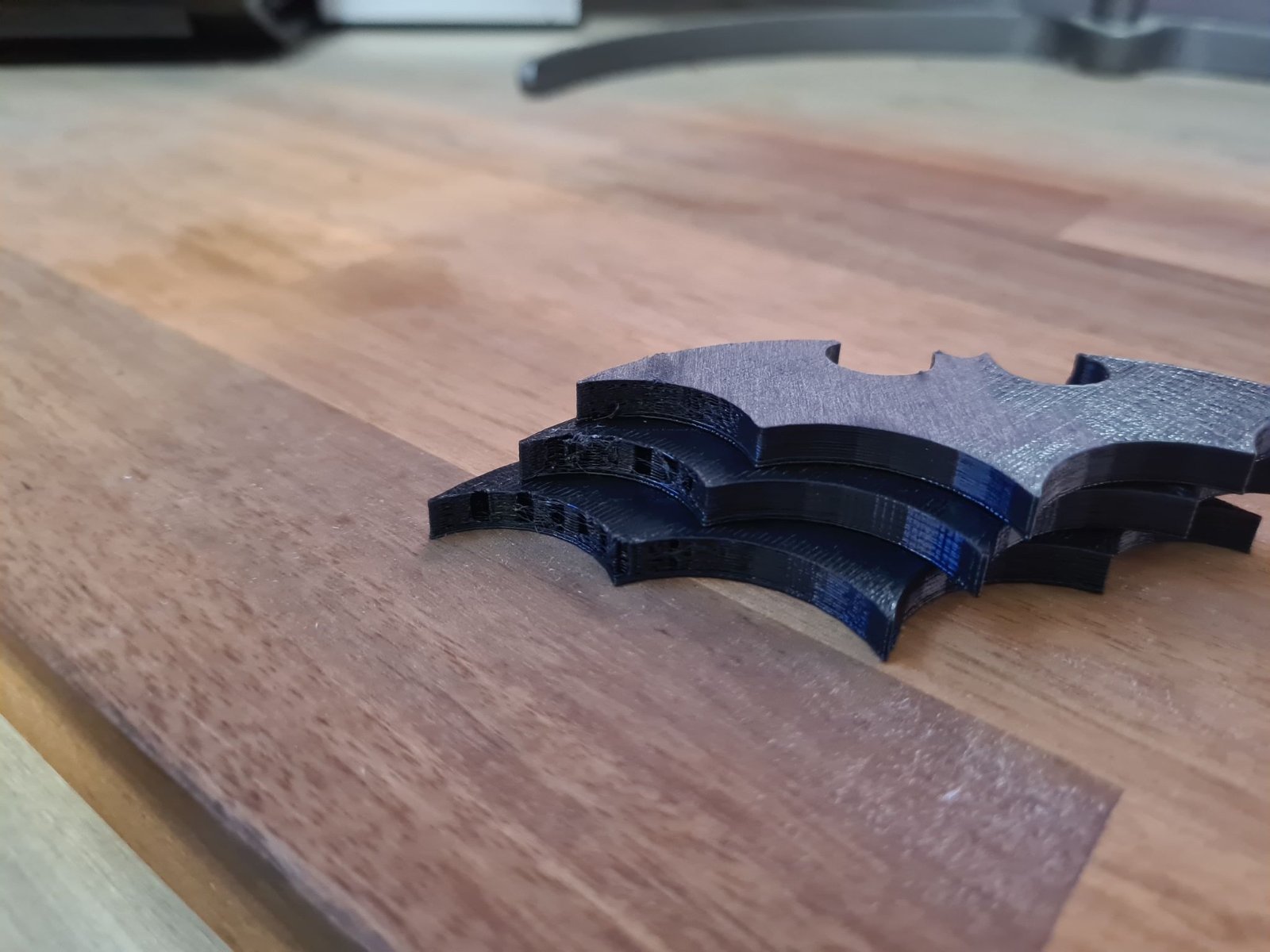

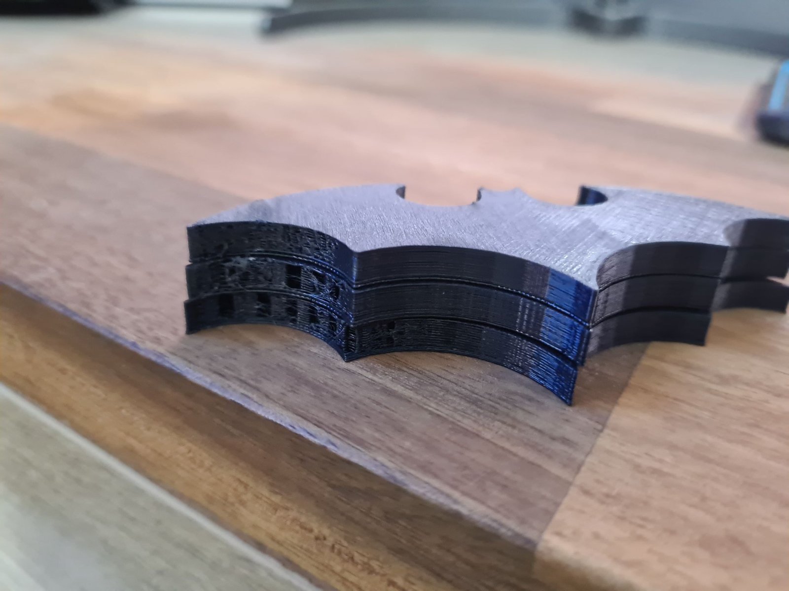

I've been having a problem with my I3 PRO B for a couple weeks now, just can't solve it. Tried a lot of things with little improvement.
Basically the first section of the outer wall of each level after the first 2 layers are faulty. I've attached some photos.
Few of the things Iv'e tried is lowering the travel speed of the outer wall, lower the extruder retraction amount and speed, Level the bed and few other things. The best I could get still isn't good enough.
Any help or advice appreciated, I'm a beginner to 3D printing.
Thanks.
Lack of extrusion at start of every layer

Hello, you may be able to change to a slicing software to print. Such as Cura, repeter-host, slic3r, Simplify3D, etc.
You can also slightly increase the percentage of underfill overlap to help close the connection. Or check z seam alignment, which helps to deal with gaps.

Awesome, I'm gonna give cura a go. Thanks for those tips, will give em a try
