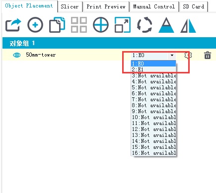

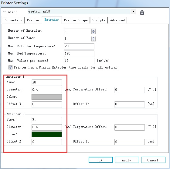

Hello, if you can't choose the extruder to work on your own, you can refer to the figure below to set it up.If you are using repeter-host.First you can set the name of the extruder yourself.Then select E0 or E1 in the position shown in the figure. :D

William, your suggestions are not very helpful. All of your suggestion were implemented before I even attempted to slice my first part using repetier....the g-code still defaults to E0 regardless which extruder is chosen.
