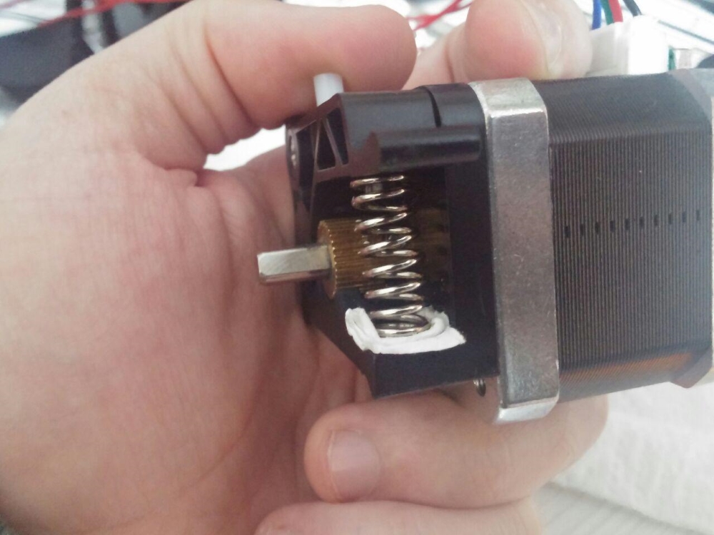

First, we need to increase the tension on the spring attached to the release lever. This is addressed in this thread: http://www.geeetech.com/forum/viewtopic ... 19&t=18507
If you don't like using paper like they did, there are shims available on Thingiverse. I used paper to get mine running long enough to print the shims. http://www.thingiverse.com/thing:1936289

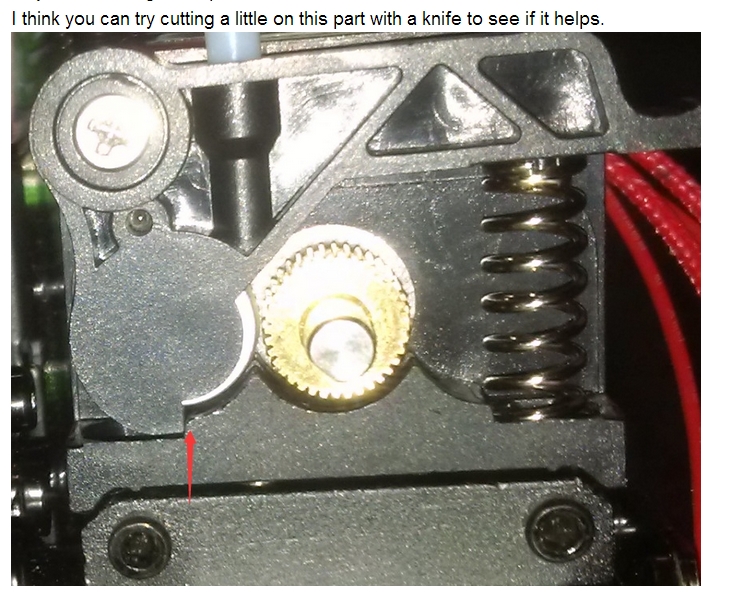

Secondly, we need to decrease the distance between the gear and the idler wheel that actually push the filament into the hotend. You need to trim some plastic off the idler arm. On mine, I took enough off so that the idler wheel rests against the gear. It works fine

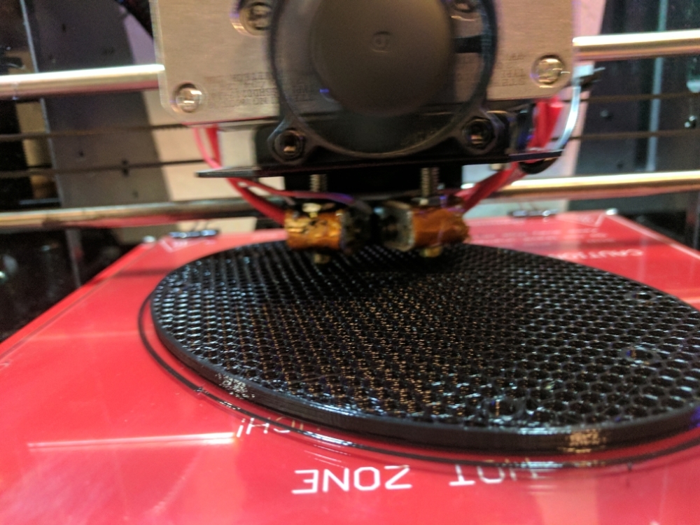

Here's how mine ended up looking:
I had to adjust the first extruder a little because I couldn't quite get the second one into the right position because of the wires and the backplate interfering.
The gaps need to be very close in size. If the gap on #2 is too low, it can bump the print (you can hear this as it crosses onto the print) and cause print problems or even scrape the layers off the bed. If it's too high, your print may not adhere or may get scraped off by the first nozzle. Getting this right may take you some time, but it can be done.
