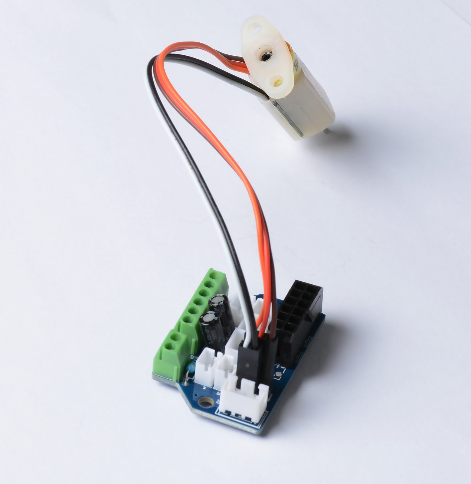

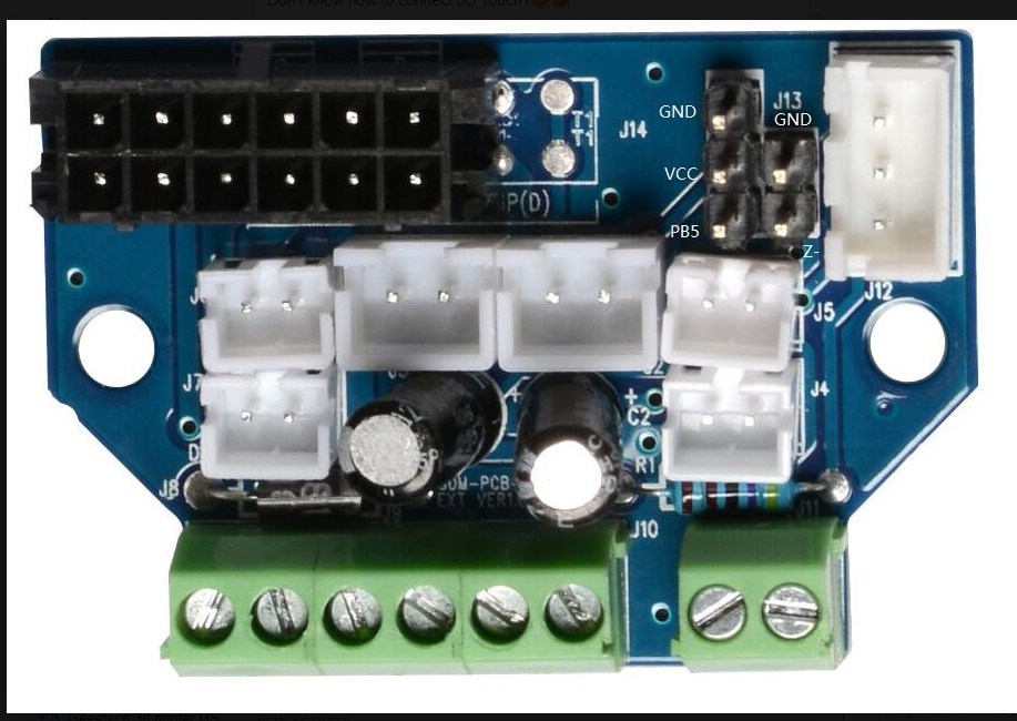

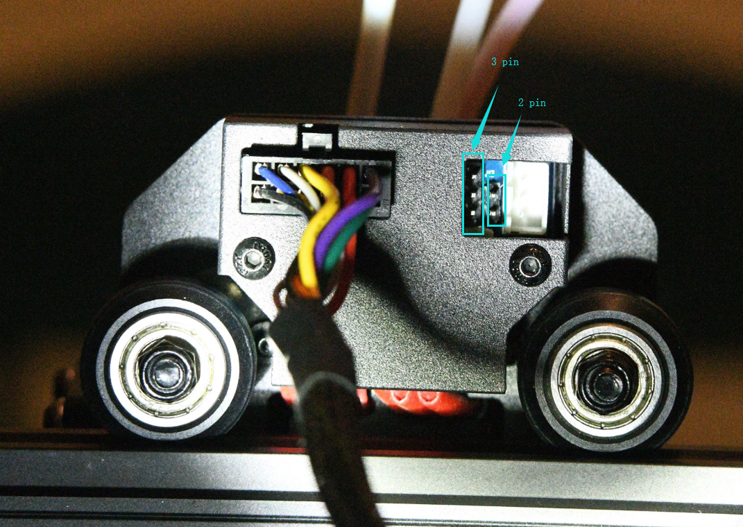

Hi,guys.
something about how to connect the 3d touch in A10T.
you can refer to this:
3d touch 标准图.png (1.44 MiB) Viewed 29619 times

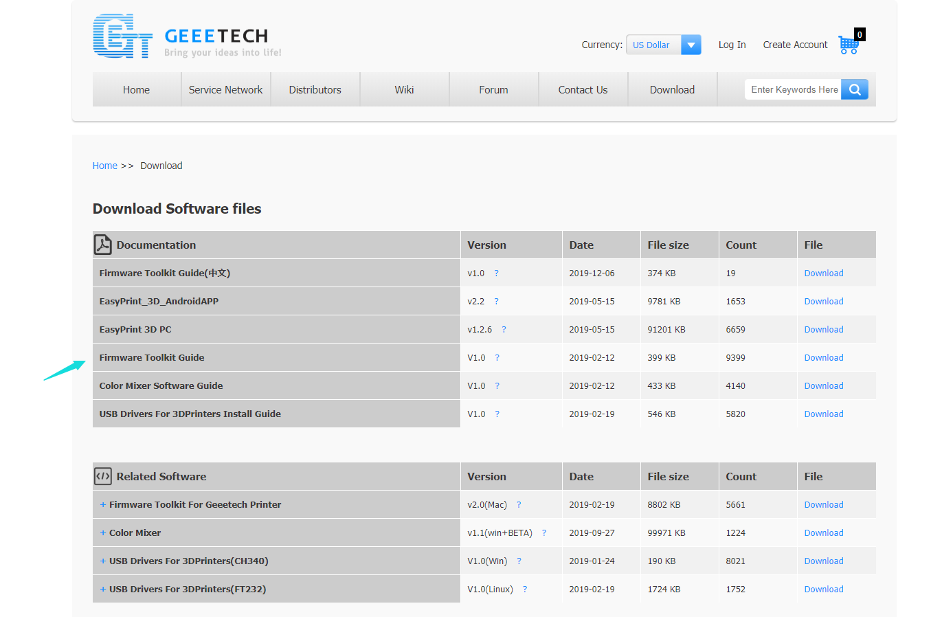

Hi, If you install 3d touch, you need to update the firmware to that with 3d touch.
You can download it here: https://www.geeetech.com/download.html?download_id=49
You can refer to this to update the firmware: https://www.geeetech.com/download.html?download_id=40
