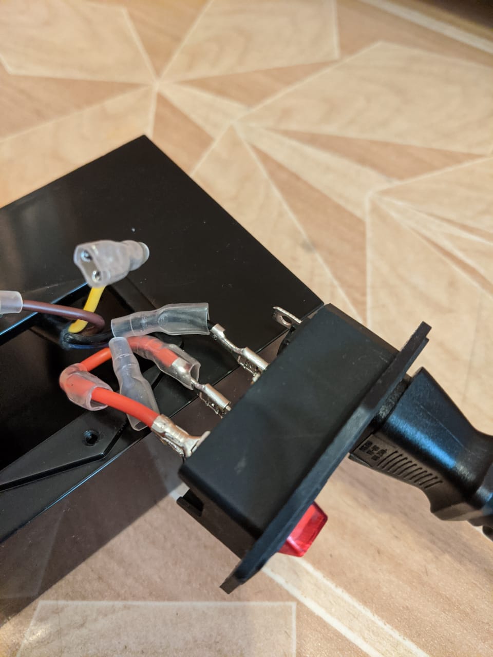

power switch input and output sockets
power switch.jpeg (89.34 KiB) Viewed 7762 times
I have measured the input voltage on the switch input power sockets - and it wasn't 220V AC - it was just 17V AC.
On the output sockets there was the same voltage.

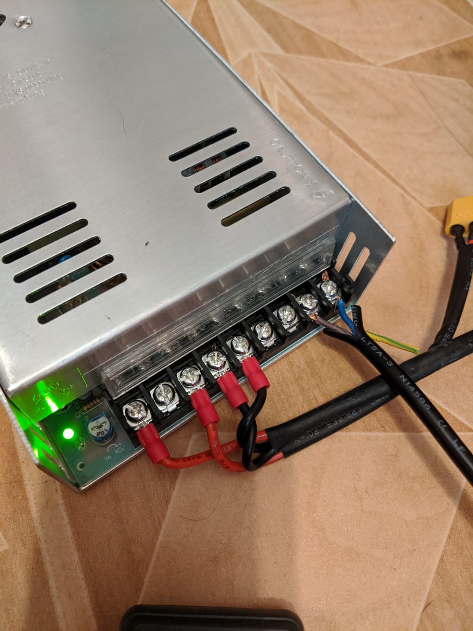

Then i wanted t know whats with the psu and i have delivered power of 220V AC to it without switch. And it works fine and the output voltage of psu was 24V DC.
psu works without power switch

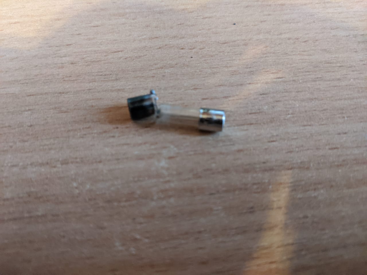

I have found the fuse in this switch, and it has done it's work :D
fuse burned out
fuse burned out
burned fuse.jpeg (80.79 KiB) Viewed 7758 times
