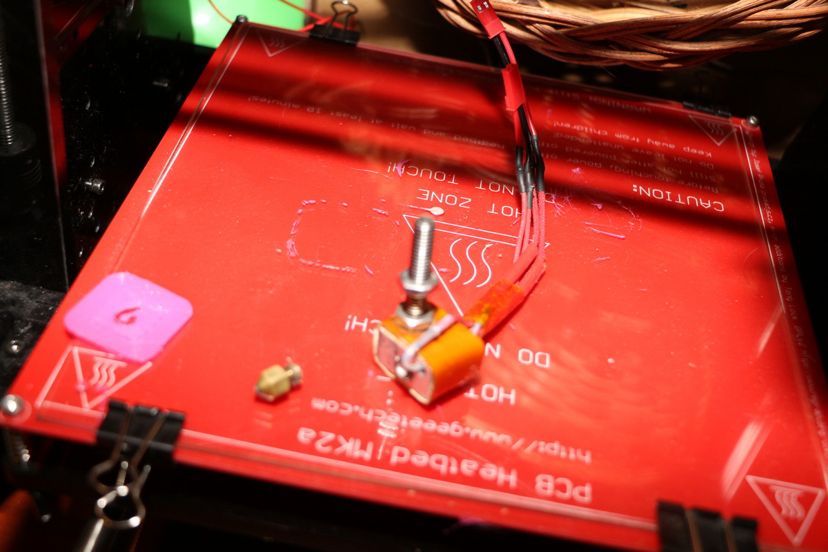

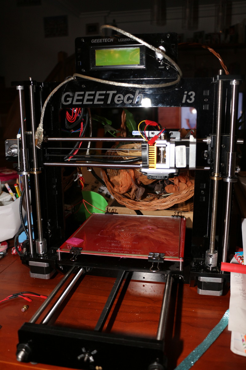

I'm a teacher. In my new school I found a 3D printer Geeetech i3. All the old teachers that know about it are missing.
My 3D printing knowledge is very (very) basic.
First question: How can I Know what model is the printer exactly?
Second question: In my tests I have not been able to print due to jams in the hotend. I have unblocked it a couple of times but it gets stuck again. In the process I broke the ptfe tube. What replacement should I get?
I submit a couple of photos
Re: Newbie in problems
:D Hi, 1. When you turn on the printer, you can check the model displayed on the display;
2. When you print out the print is inconsistent, you can try to check the spring tension on the feeder.
If it is too loose, you can add the paper jam at the spring to adjust it. If you mean to break the tube, you need to do it. replace.

Hi pfuente,
Your printer looks all but identical to my 'Geeetech i3 Pro B'.
If you're ever looking at Thingiverse (Good place for student printing projects ?) there's a photo of my machine here...
https://www.thingiverse.com/thing:3616021
OK, I have fitted a component fan and bed-probe, but you can see they're the same.
So... Jams in the hotend ?
I'd change the nozzle - they cost just pennies on Ebay/Amazon
Go for a 0.4mm nozzle - mine came with 0.3mm (Doesn't sound a lot, but it is when you start !)
Check your extruder - I've had far more issues with jams/blockages and bits of filament here than with the nozzle.
Take this apart, clean out any debris and re-assemble.
Clean and lubricate all the X,Y and Z axis rods and drive-screws, they'll be dusty and in need of some light machine oil ('3-in-one' would be a good choice in the UK)
Make sure everything slides smoothly when the machine is switched off...
Start printing at half the speed you think you should to start with !
I've had very few errors due to slow printing, but loads when trying to print too quickly !
Make sure you have fresh filament, unless it's been kept in a dessicator, old filament may give you problems. (It absorbs moisture over time)
Let us know how you get on.
Gerry
