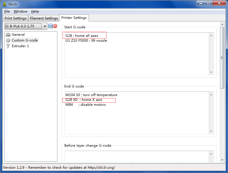

Hi there , my Printer has decided that when it has finished printing the last command it stops at that Point and does not home automatically ! Any suggestions whats up with it ?? Hope you can help !
Re: End of print but stops and does not return home
Hi,I wanna know which printer are you using?You can add End G-code command in the Slic3r of Repetier.The homing command is G28.
