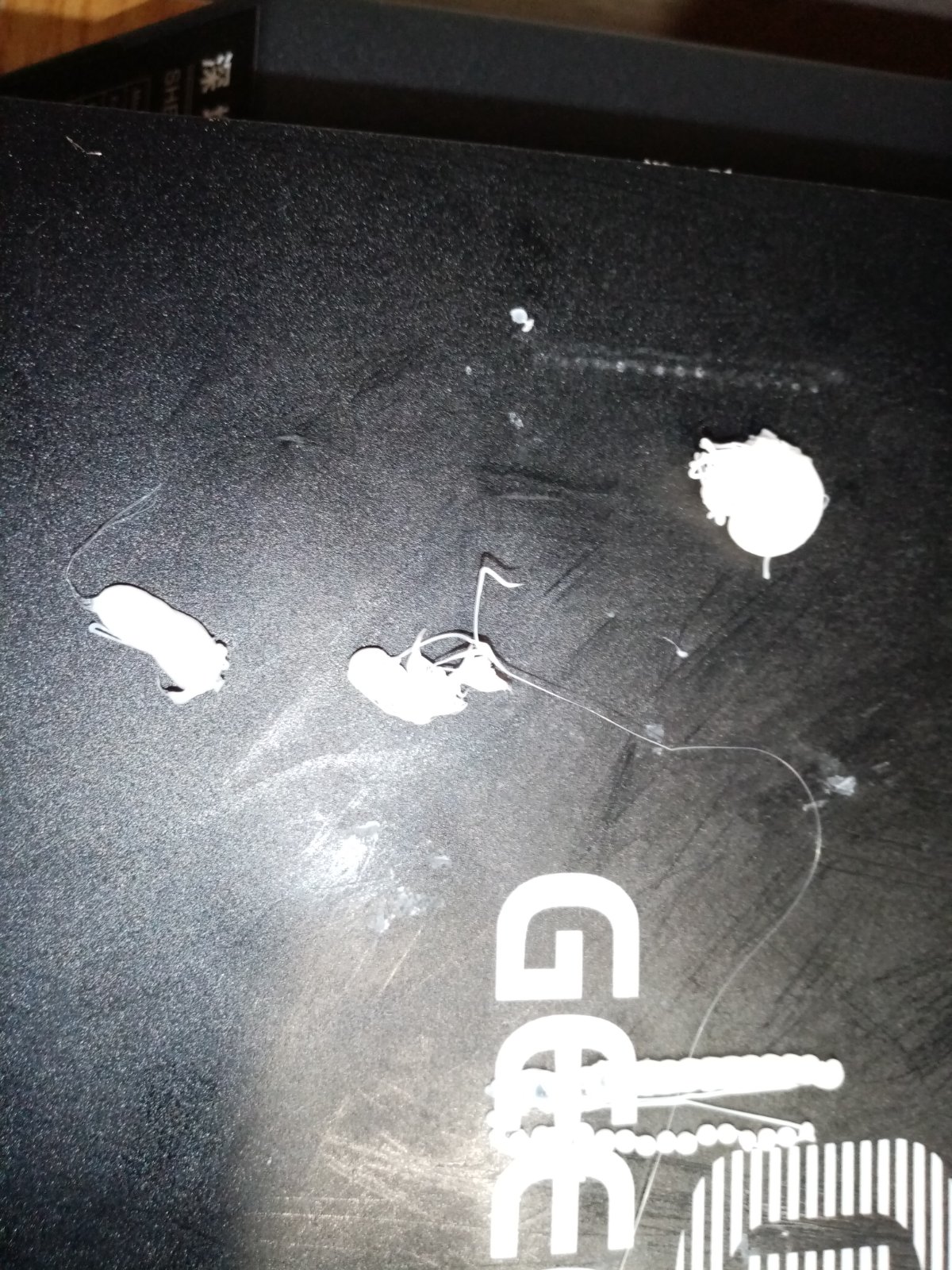

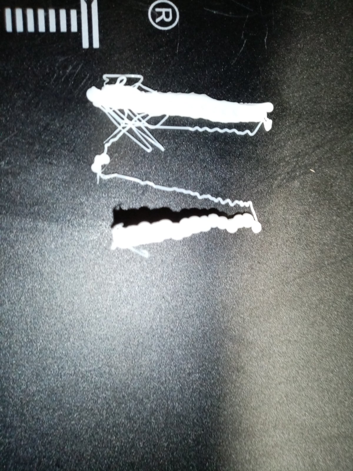

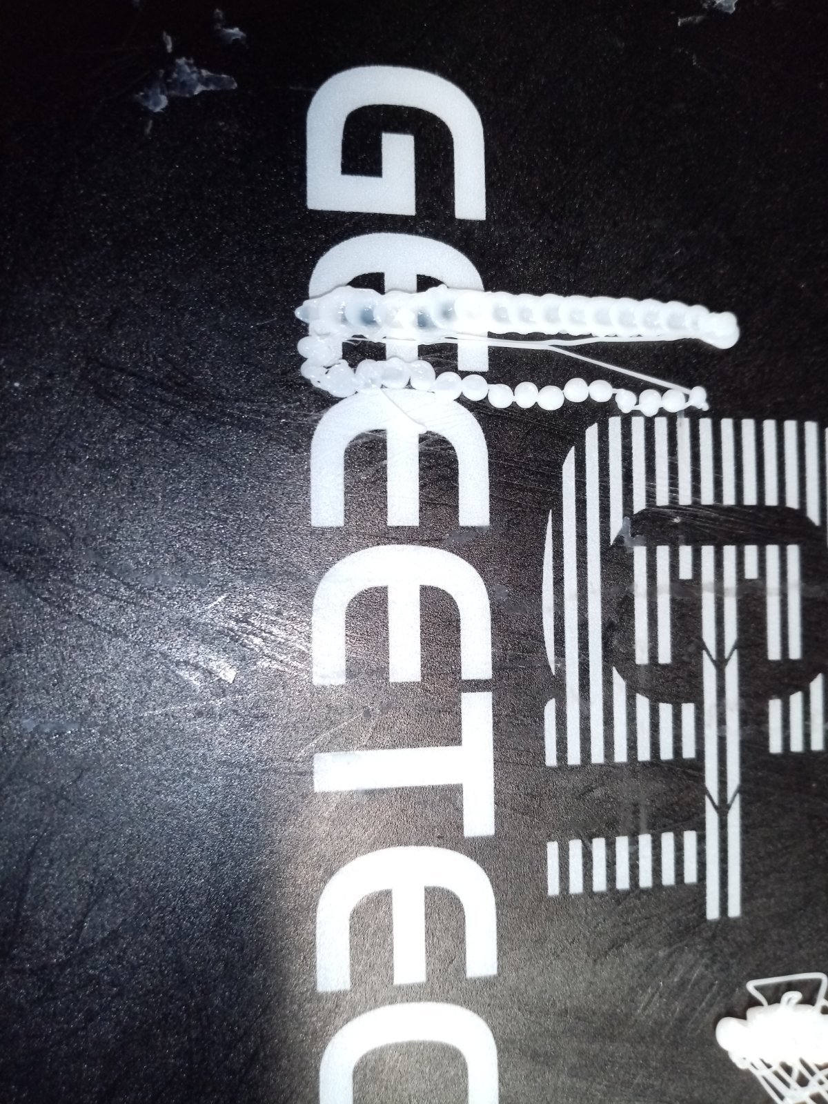

problem is when i try to print the test piece on the memory card provided, my printer makes a grinding noise and prints "wiggly lines" then starts printing pla like crazy and then clogs its head up. The whole time vibrating whilst it works.

These are the clumps that come off the nozzle
Stuck to the print bed "wiggly lines"
Previous Failed print with more "wiggly lines"

it looks like the axis is too tight. try to move the axis manually. once without power by hand and once in the settings with move axis. is the distance between the nozzle and the bed correct?
