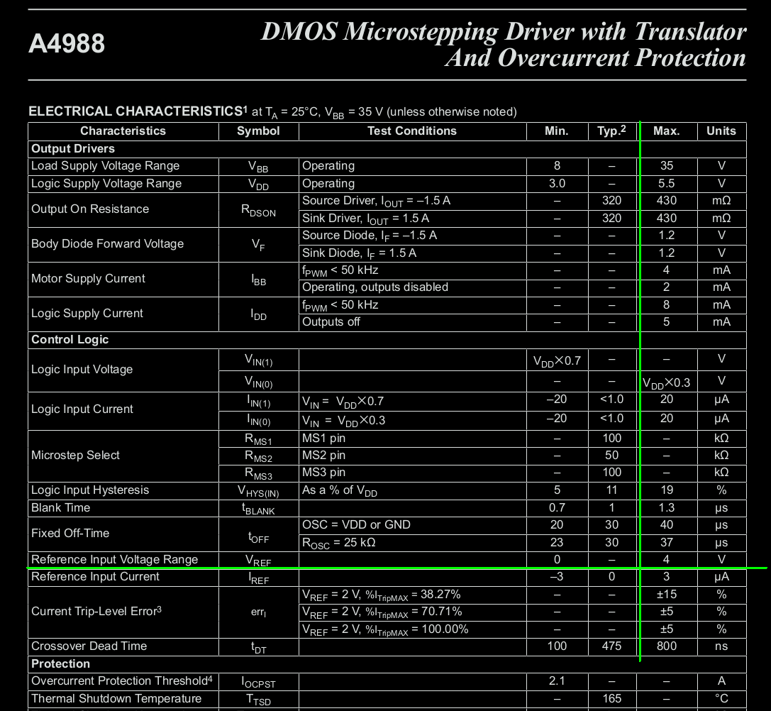

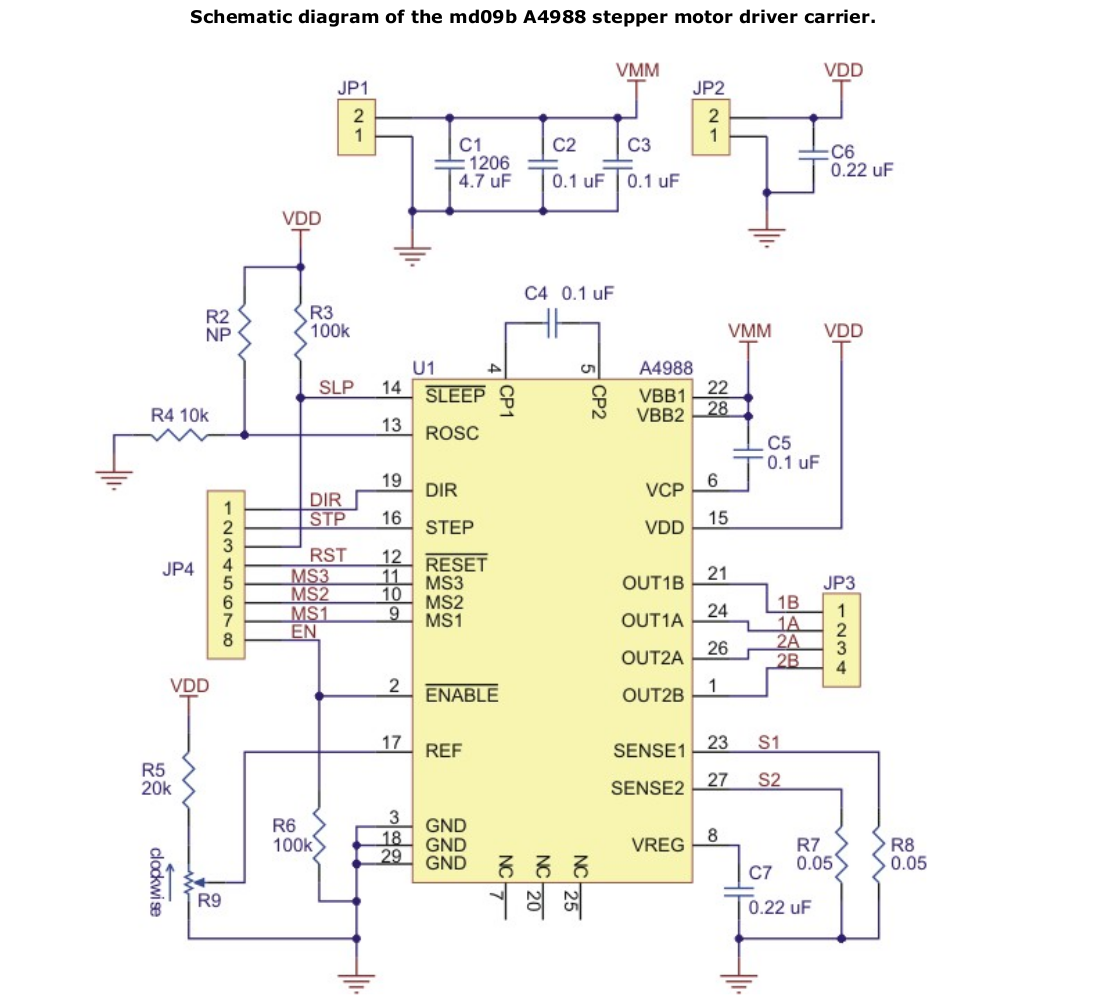

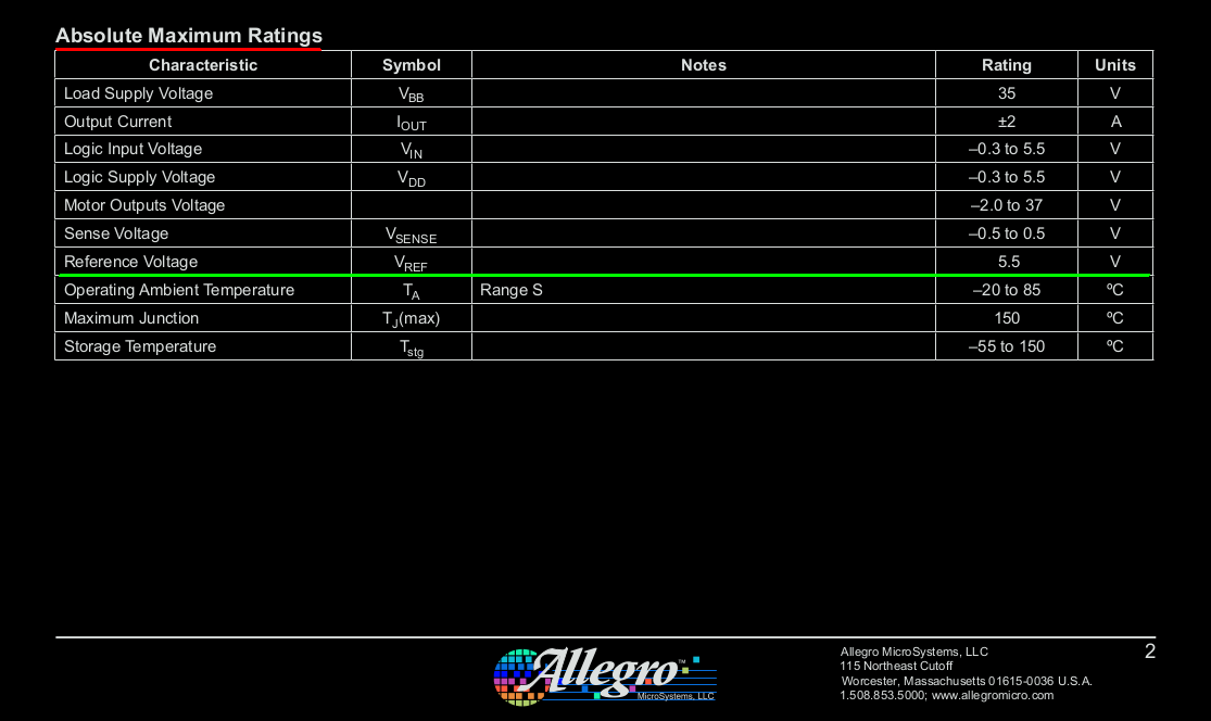

Re: Turning up current - A4988
Hi.
A good question.
The stpstick module uses two voltage levels Vmot and Vdd.
You said that you read the catalogue note so you know that Vmot is the voltage supplying the executive part (stepper motor), Vdd is the voltage supplying the logical part of the system.
The content of Wiliam's statement shows that depending on the controller's board model, the Vref voltage can be increased to the limit value defined as Vdd. What seems logical not to supply the system with voltage higher than the voltage supplying the logical part.
If we look at the catalogue note we will see interesting data tables. . While in the first table the manufacturer allows 5V5 as the maximum voltage for this input, one must be aware that it does not have to be the correct value.
The next table presents the value of 4V0 for this input as the maximum recommended.
I managed to get a module scheme where we can see that the actual maximum value (Vdd) is additionally limited by a resistor.
One more essential remark:
And here it is very important.
So we all learned some interesting facts.
I recommend to everyone to read the technical documentation.
At least a little bit.
