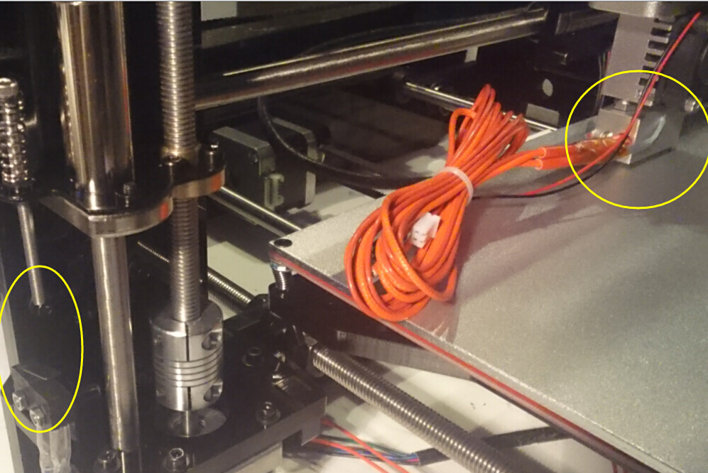

If anyone bought the I3 M201, and find the nozzle is crashed to the bed far before the endstop is triggered:

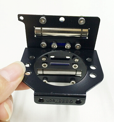

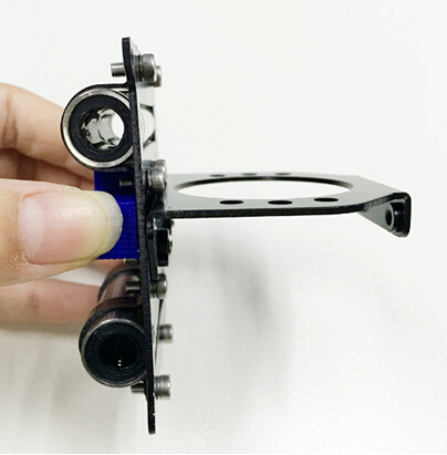

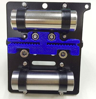

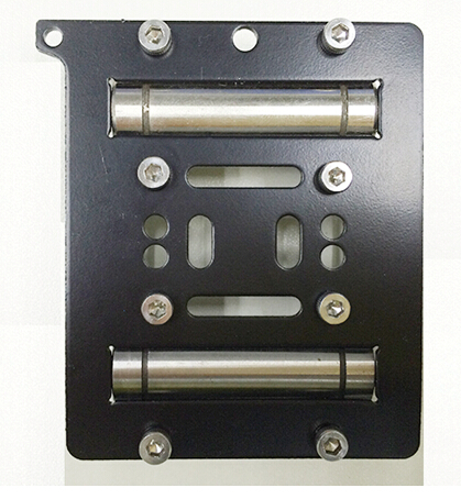

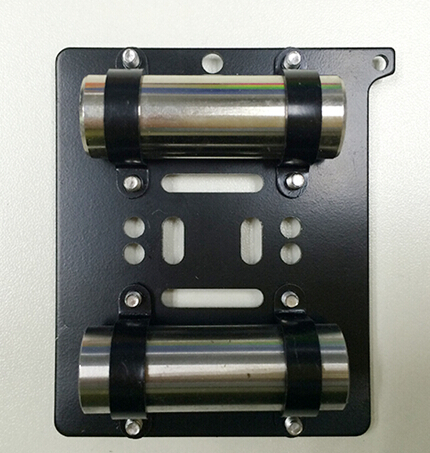

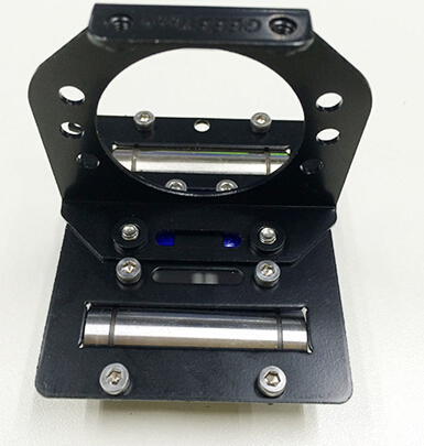

Please come to 18. Assembly of the extruder carriage and assemble the X carriage like this:
Step1.fix the 4 Bearing Brackets on the back of the X Carriage loosely with M3x6mm screws. Insert the linear bearing into the slot and screw the bracket tightly.
Please notice the front and back of the plate.
The following steps differs from the video, please build based on this manual.
Step2.Fix the belt mount on the back of the carriage with 2 M3x 12mm screws and M3 hex nuts.
Step3. Fix the extruder holder on the front side of the X carriage using M4x6mm screws.
That's all.
