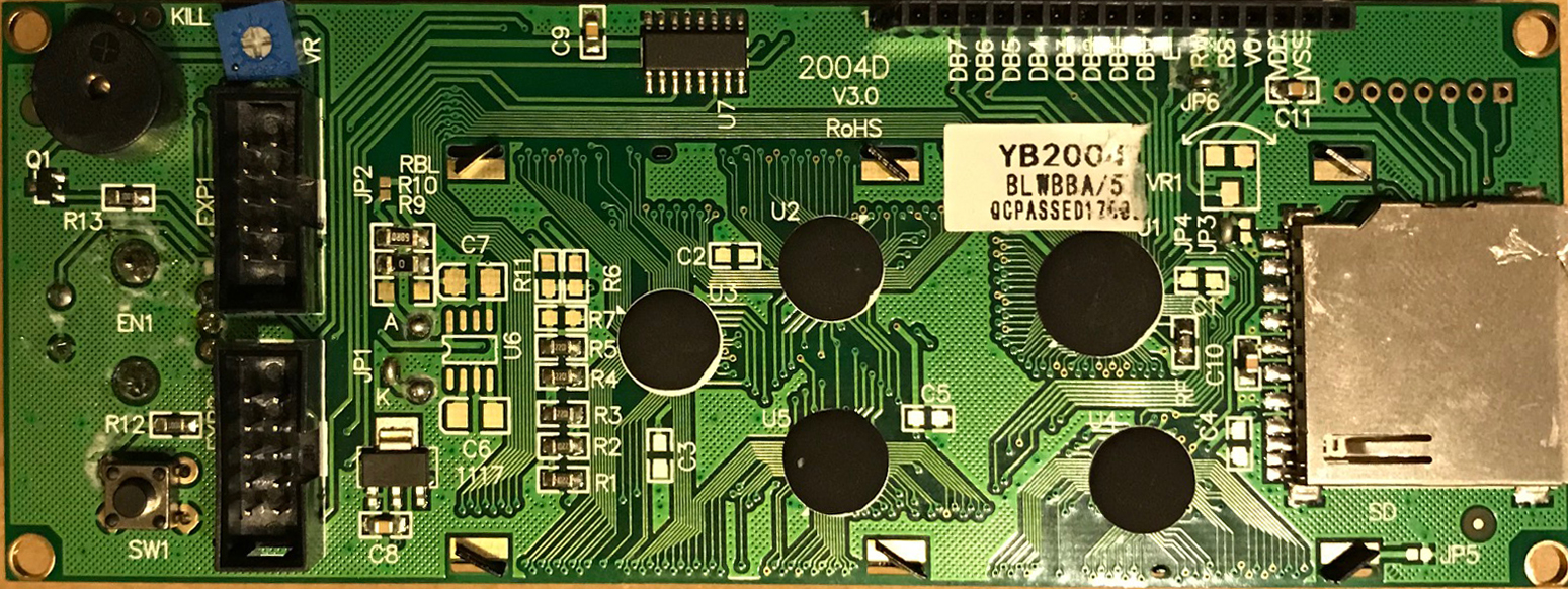

Hi, I have an unknown LCD2004 display and controllboard.
I don't know what kind of type I should select under Marvin. I allready tried some without success.
Can anybody identify this board by the pictures?
thx
unknown LCD2004 controlboard (Marlin)
- LCD2004 rückseite.jpg (921.63 KiB) Viewed 5299 times
- LCD 2004 Vorderseite.jpg (678.39 KiB) Viewed 5299 times

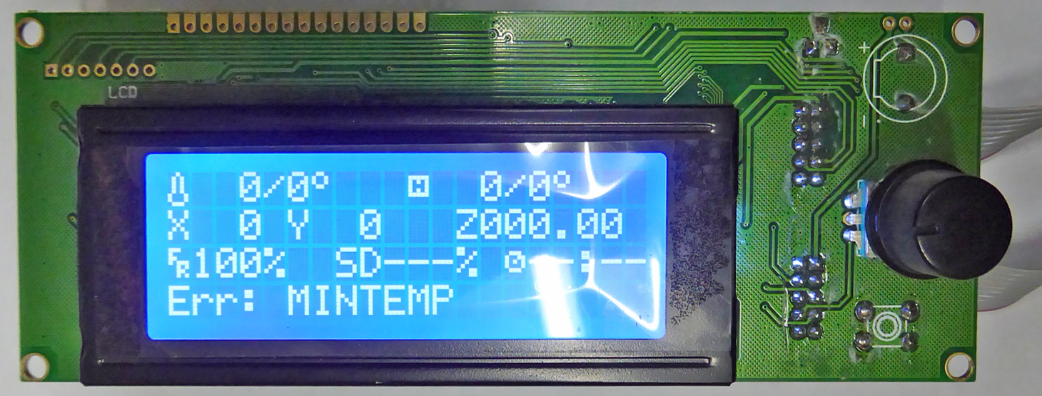

OK, I found a similar problem here, so I ground off the noses of the connectors and put the cables in the bases front to back.
Then the display works as a normal LCD 2004 and also the controller works.
>>> I just recognised that it only works, if there is a I2C Interface connected to the dispaly. I wonder why - but ist works this way.
