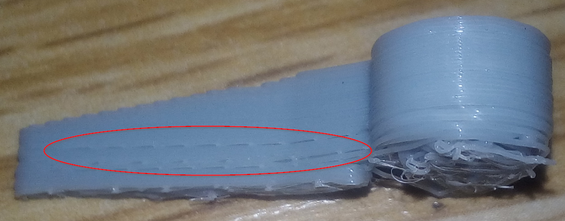

I have A10M and sometimes I see a quality issues on my prints. It seems that there are skipped layers in the print.
I will be glad if anyone of you have solved it and can share his suggestions.

2021-01-10 20_15_18-IMG_20210110_200816.jpg - IrfanView (Zoom_ 2344 x 1758).png
2021-01-10 20_15_18-IMG_20210110_200816.jpg - IrfanView (Zoom_ 2344 x 1758).png (881.71 KiB) Viewed 7006 times
