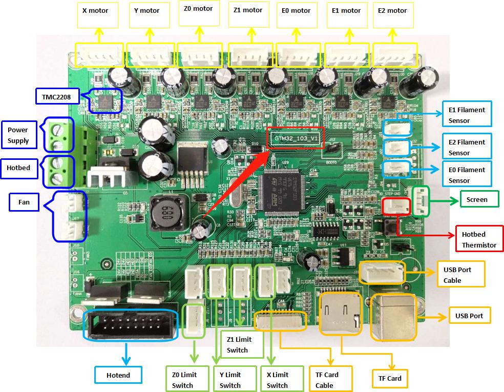

Got it, opening the printer will help to understand :D. My printer has the MB11 (GTM32_103_V1):
What I mean is to use the buck converter, solder an old fan cable to its input and connect it to a spare fan connector on the printer's mainboard. My board has two of it (on the left), one is occupied by the case fan, one is free. The printer mainboard contains a USB-B port you can use for connection to the RPi after you removed the USB-interconnection cable from the extension port. So can place the RPi inside the casing.

Ohhh that's what I was hoping but I am curious of the specs of those 2pin fan headers. I feel like Geeetech should have that info but I feel like it would be hard to get the answer. Cuz a 40mm fan might be something like 0.06amps, but the Pi might be about 1amp, so idk if that would be a good idea for those fan headers. Unless the buck converter makes that safe? Sorry I am not terrible with electronic stuff, but its been about 12 years since I was in school and had a class on them. I like the idea of the USB port on the inside though, I didn't know it had one of those ports. I really need to open my printer up but I keep putting it off until I measure it for an enclosure since I wanna use ABS

MOCCOR wrote: Sat Mar 20, 2021 5:01 am Ohhh that's what I was hoping but I am curious of the specs of those 2pin fan headers. I feel like Geeetech should have that info but I feel like it would be hard to get the answer. Cuz a 40mm fan might be something like 0.06amps, but the Pi might be about 1amp, so idk if that would be a good idea for those fan headers. Unless the buck converter makes that safe?
The JST 2.0 mm connectors for the fans are rated for 2 amps per pin, maybe as a chinese knock-off they will carry one amp to make it safe. Since the connector carries 24V and the PCB trace are beefy enough this means you can draw 24 watts out of the connector. Converted by a buck converter down to 5V this means you'll get 4.8 amps current for the RPi supply. IIRC the Pi draws 3 amps peak (15W) and averaged with octoprint running maybe 1 amp (5W). So this should work.
