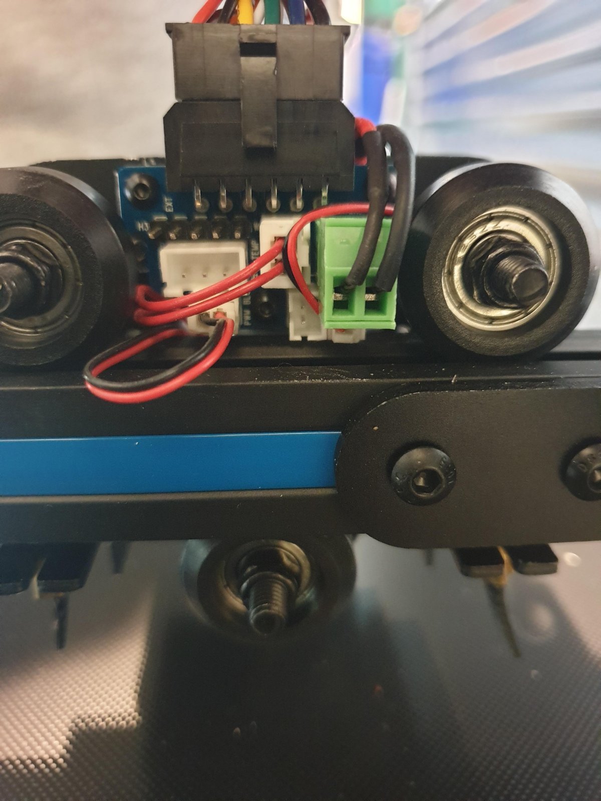

I'm new to 3D printing and recently bought a boxed, unused A30 which I've assembled this afternoon (it was obvious the printer had never been setup before). Upon levelling the bed and fed in the filament I attempted to a print, the bed heated up but then errored:
Error: Nozzle 0-TEMP
The heating element is out of order
I then tried to turn up the temperature in settings which also resulted in the same error message.
I've looked at the forums and videos of people who have setup this printer and double checked all the steps as per the installation guide and cannot identify the cause. I have since upgraded the firmware as I wanted to ensure I was running on the latest available version.
Although I work in IT, I'm familiar with using a multi-meter as I used to be a copier and alarm engineer but not sure how to test the thermistor, see attached photo of the connections on the nozzle assembly.
Thanks in advance for any help.
Pete

A follow up to my post.
I've since found either a poor connection or faulty thermistor so I will take this out over the weekend to check it over. In the meantime I was see if I can source a replacement just in case.

Re: Newbie - New A30 with "Error: Nozzle 0-TEMP"
Update: I've removed the thermistor and checked the resistance and it is working as expected and the same as a spare I have so having checked the connections, I'm not entirely sure as to the cause.
When I heat the bed before the filament the hot end does get hotter but the temperature still reports -19 which suggests it's not connected to the thermistor.
Judging by the frequency and last posts on here I'm not sure there is much of an audience but hopefully someone might be able to help.
Thanks
Pete
Update on the reported issue - I replaced the hot end which came supplied with a thermistor which resolved the issue.
