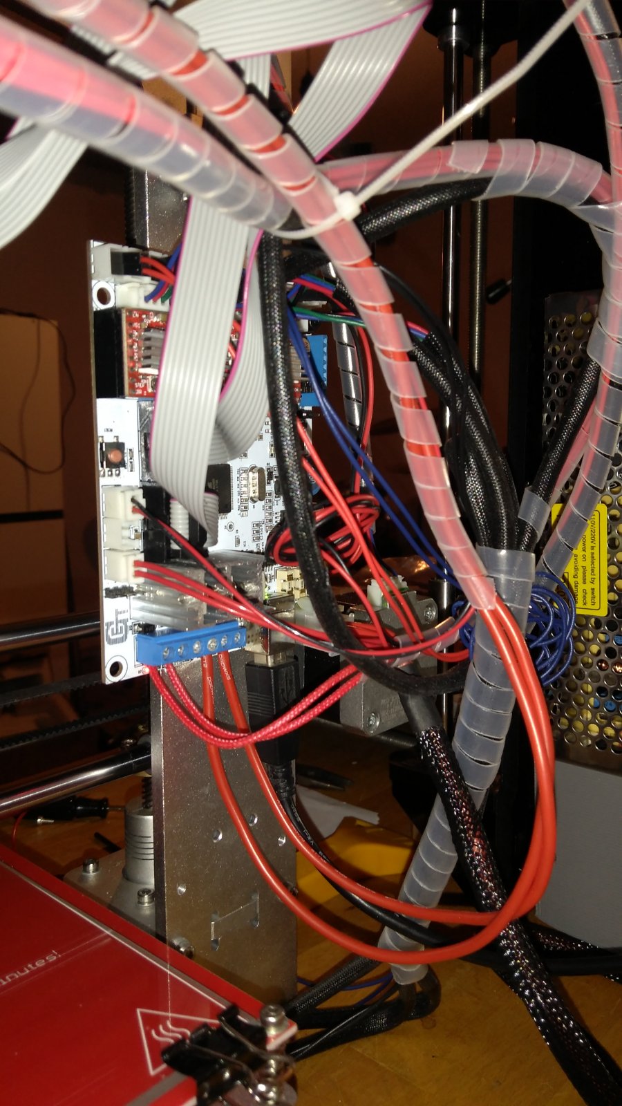

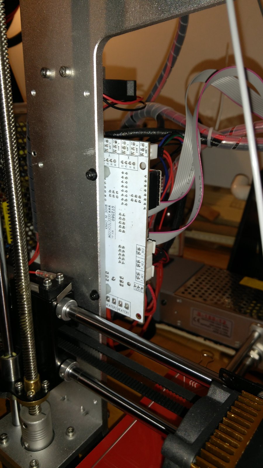

Hello,
I have mounted a 2560 Board from a i3 Pro W to my I3 Aluminium and this works rather fine:
Here, on the right side, there are only twi distance holders, the board is mounted only with two screws. But it seems to be very stable and I used distance holders on both side of the board, this should be safe enough:
It seems to be the better solution. One reason was, thet the SD Card reader didn't work and there are more settings possible through the display then with this small board coming with the i3 Aluminium.
