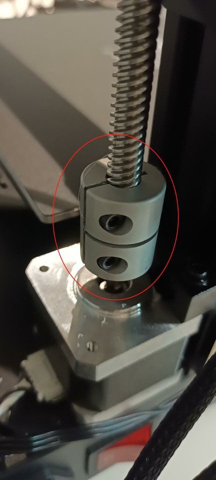

Hi, I have problems with the z wobble on my PRO W, do you know what the problem can be?
I tried many solutions that I saw on the internet but it keeps happening.

Hello, you can check whether the coupling is not installed correctly, or the defect of the two Z-axis screw rods, you can take it off and put it on the table for comparison.
