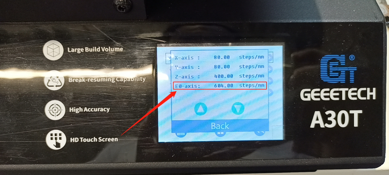

You can change the E steps/mm, like the picture below, that will change all the extruders.
- A30系列修改E电机传动比.png (1.86 MiB) Viewed 92545 times

tat''s the firt thing I have done..
but didn't work for me..
I fixed mine setting the flow at 35% and saved wit M500 gcode.. it worked on all the extruders

tat''s the firt thing I have done..William wrote: Fri Aug 20, 2021 10:40 am Hi,
when you change that value only the first extruder will be affected.. at least on my 3d printer...
