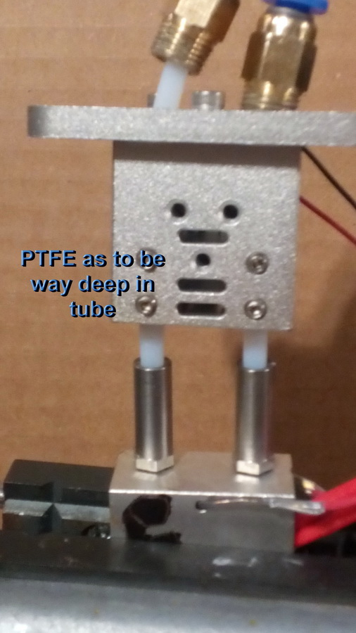

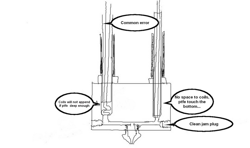

So to help other with some details That should have learn faster is the pig tail symptom. When the filament get pig tail...I n my case it looked like to issue bad temp and
my ptfe not deep enought in the nozzle assy...
The spacing  in the left permit the filament to coils an jam in the tubing forcing you to remove the ptfe tubing and make it even worst if you not insert it properly again...It is always fun to see a picture to figure out I should have none better...Else on the right side you would get noise  like tok tok of your  extruder and not a major jam...
extruder ptfe distance resize.jpg (54.39 KiB) Viewed 20111 times

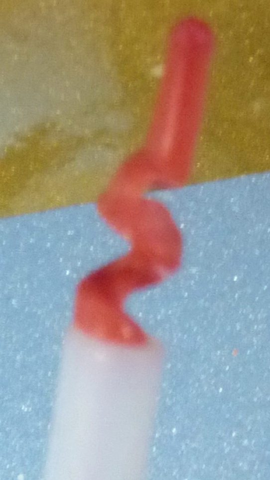

Example of what append to your filament when you have the wrong spacing...like in my case and wrong temp...
Coils when bad temp and enough space to coil IE ptfe not deep enough...
bad ptfe pos.jpg (122.02 KiB) Viewed 20111 times

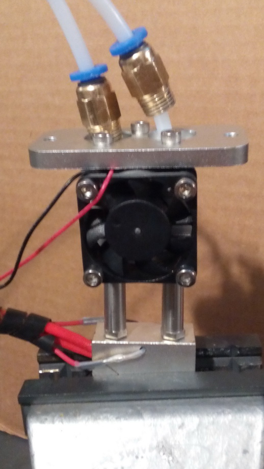

I had to dismentle so many time I thought to share the picture to figure how deep ptfe should be...
Front view
Front view
extruder ass1 resize.jpg (121.07 KiB) Viewed 20111 times
Rear view where there is allen key to  slide the heath sink away...Do not forget to re tighten them to hold and dissipate the heat...
extruder ass2resize.jpg (122.58 KiB) Viewed 20111 times
