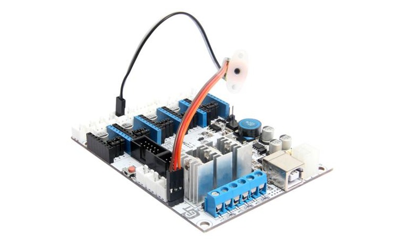

OK, the problem was the Arduino board, it is a general issue for this board
My Geeetech Pro W comes with GT2560 A+ so the three pin that wiki says you have to connect at boardh is not valid. You have to connect it as below image I attached.
And you have to change in pins.h
Wiki says:
#define SERVO0_PIN 32//13 // untested
You must to put pin 11:
#define SERVO0_PIN 11//13 // untested
It works now, but I'm not able to calibrate.
when I write "G1 Z0" command bu the nozzel is far away from bed. my Z offset is -5 (the minumum value because my configuration.h support max -15 min -5) I cannot put -4 or less.

Re: Problem with BL touch calibration
I think you can refer to this post
viewtopic.php?f=20&t=19846
Yes i saw it but i dont know how to set my Z offset, it is always at same altitude. This firmware comes with -1.29 offset and it is so far away from my bed. I flashed +2, 3, 5 but nozzle is always at same position. So, i dont know how to calibrate it.
My Printer is the pro W, i know it is the same than pro B but i dont it this frimware is valid.
Thanks for your reply my friend
