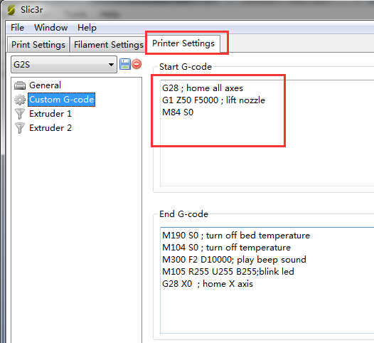

Hi guys, if you run into the problem that the G2S extruder2 drives axial motors when printing, you can try to solve it by reinstall the latest firmware, and change some setting here. You can have a try but ready to press the emergency button if necessary!
Download the latest firmware here:
http://www.geeetech.com/forum/viewtopic ... 10&t=17046

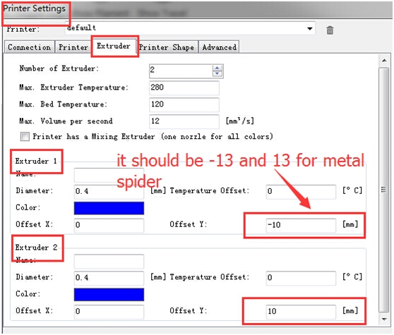

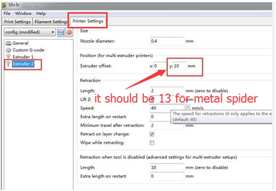

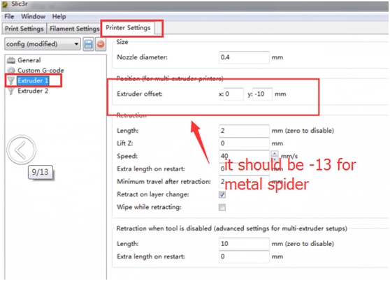

For the distance of the two extruders is 20mm, you should set the Y offset in the printer settings and the slice software as follows.
Do note that if your spider is the metal one, the distance is 26mm!
1. printer settings:
2. settings in slic3r:
3. Add "M84 S0" to the gcode here:

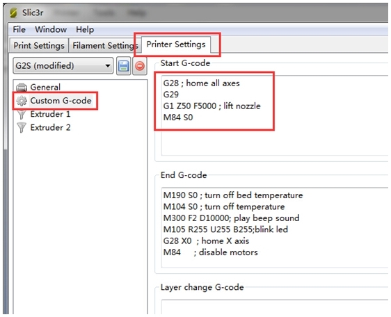

If you want to add the G29 to test the auto-leveling, add it here:
