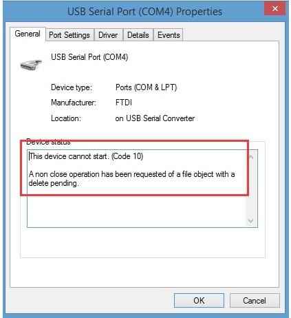

2. The driver is not well installed
If your COM port show the same information as the picture shows, it seems the driver is not well installed.

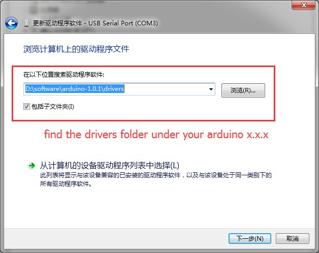

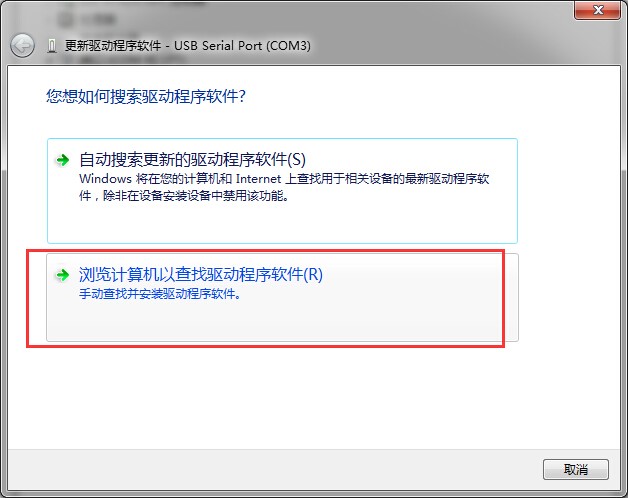

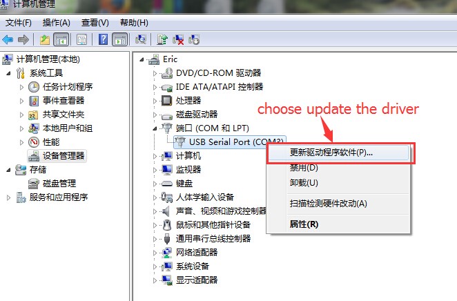

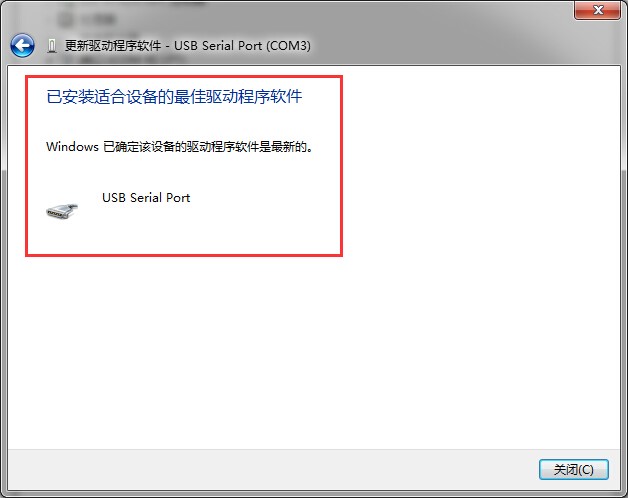

Try to reinstall it like this, and remember to select the correct COM port and motherboard in your arduino.
step01:
step02:
step03:
step04:
After this you can try to connect to your PC again see if it works.
