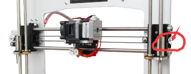

1.Make sure the both sides on Z axis are staying at a same height:
[attachment=3]1.png[/attachment]

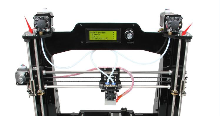

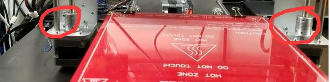

3.Check if you the two couplings on Z axis correctly mounted:
[attachment=2]2.png[/attachment]

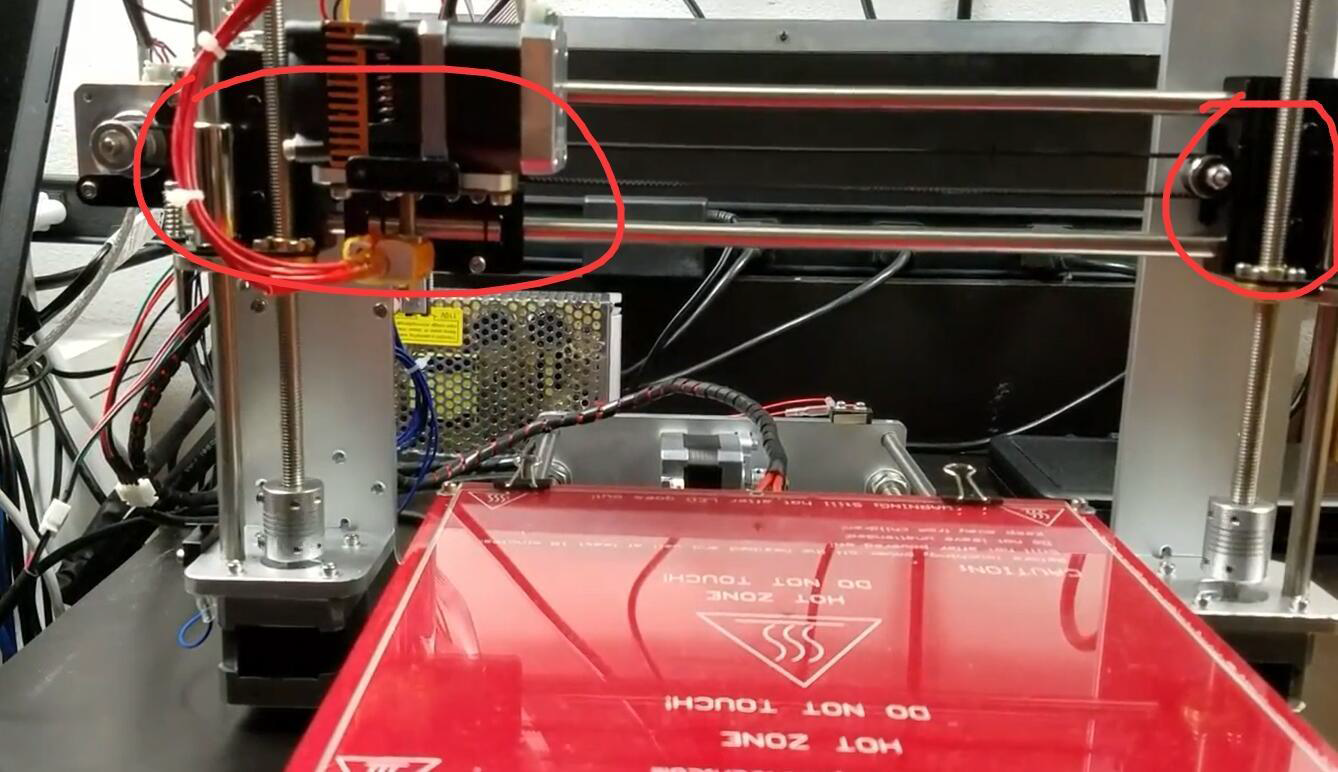

4.Loose the belt on X axis by adjusting the nut to see if there is a difference:
[attachment=1]3.png[/attachment]
