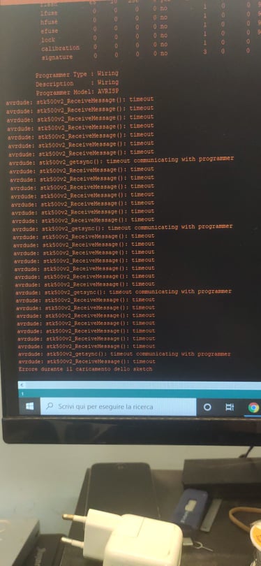

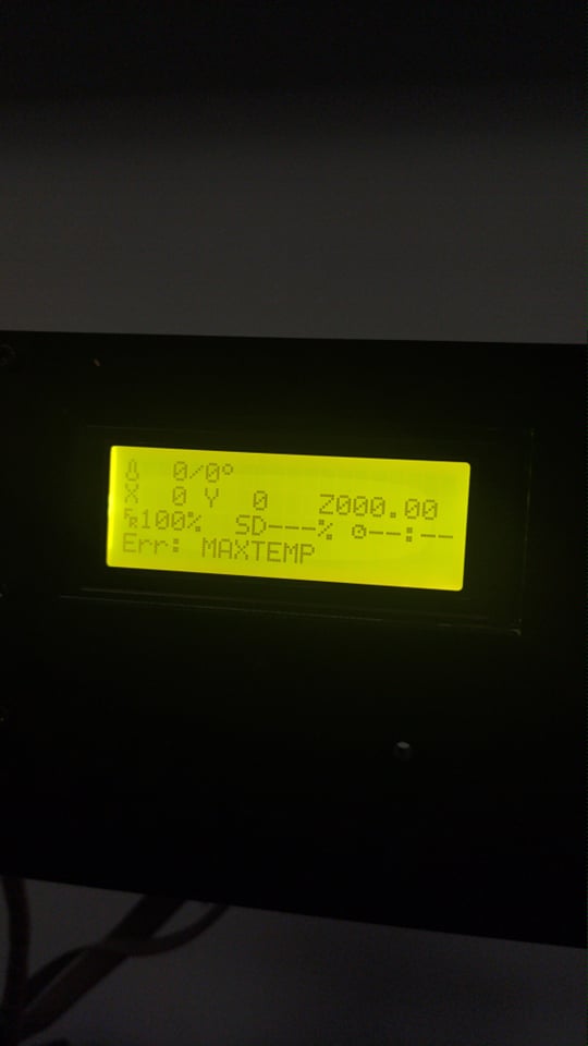

1) After the update of the firmware with Arduino I've the "MAXTEMP" error on the LCD and this error on Arduino IDE:
avrdude: stk500v2_ReceiveMessage (): timeout .
2) The printer port (COM) was recognized in the various software but it was not possible to provide it with commands of any kind.
3) On the Arduino activities monitor related to a specific COM were not always shown the activities of the printer, to do so, it was necessary to open the monitor window, completely disconnect and turn off the printer and reconnect it before turning it on.
4) pressing the reset button of the printer the situation did not change.
5) the yellow / orange led on the board flashed very quickly.

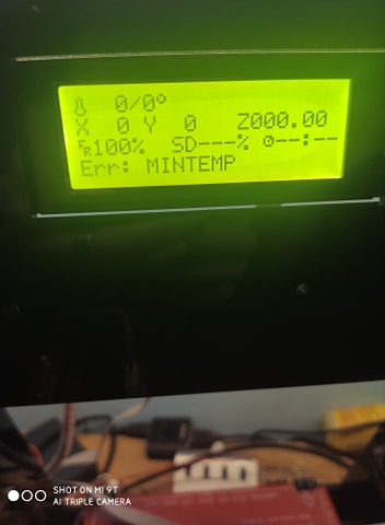

First of all thanks to the intuition of my friend, who took care of fixing the firmware to be loaded at the same time, we found the method to stop starting the "MAXTEMP" error. By initially trying to connect the temperature sensor cables, the result has not changed. We therefore decided to invert the cables and move them one position, so that they were detected as if they were two temperature indicators of the extruders instead of extruder 1 + plate. The result, sensationally, changes. So we get the error "MINTEMP" ... it is not much but it is an honest job.
The printer is therefore no longer completely blocked as before, a minimum temperature error does not completely limit the functions of the printer. However, the result of the loading is always negative and reports the same error, on the screen it does not receive the commands.

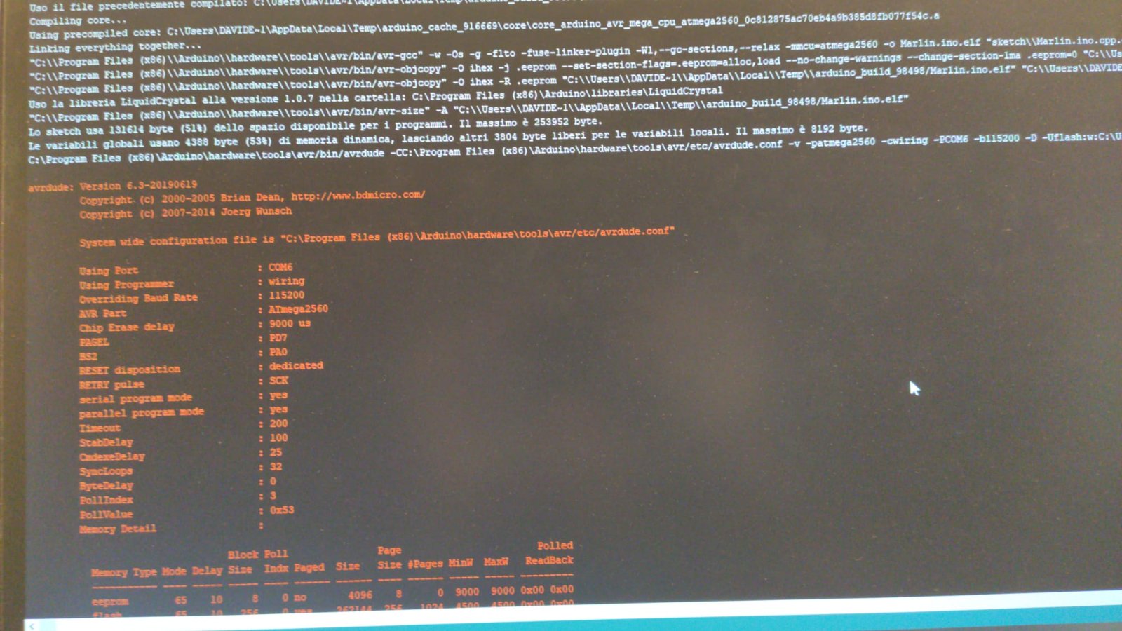

Now let's try to load the firmware but we don't succeed at the first shot ... It is therefore deduced that the buttons must be released at the exact moment in which the firmware compilation procedure is finishing.
Final attempt:
- turn on the printer and connect it to the pc by keeping the reset button pressed.
- release it after 3 seconds by pressing the LCD button immediately
 and alternate them every 3 seconds until the end is over
 compilation by arduino. To be clear, just
 the firmware loading phase will begin. (release at the beginning of the orange string)
The upload finally goes
From then on, every other upload will go every time without repeating the same procedure, but completing it normally.
