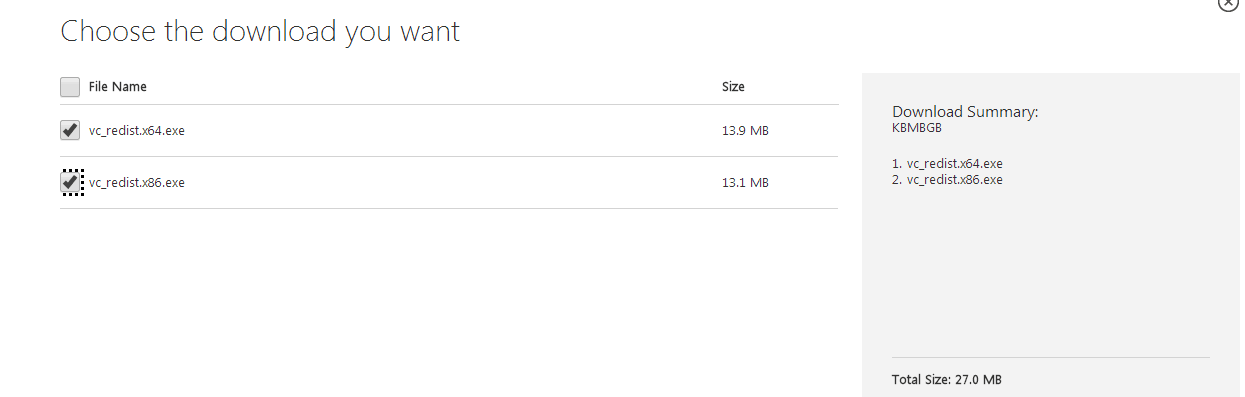

If you are using Easyprint 3D to slice the file, and it shows like this.
"EasyPrint stopped working. The problem caused the program to stop running the System Windows program terminates to notify whether it is available"
Then you can download visual C++, here is the link.
https://www.microsoft.com/en-us/downloa ... x?id=48145
click download, If your compuoter is 32 bit, you need download "vc_redist.x86.exe"
If your computer is 64 bit, you need download them both.
Caution:you have to download one by one, first you need download "vc_redist.x86.exe", then after installing it, you need download "vc_redist.x64.exe"
then restart your computer.

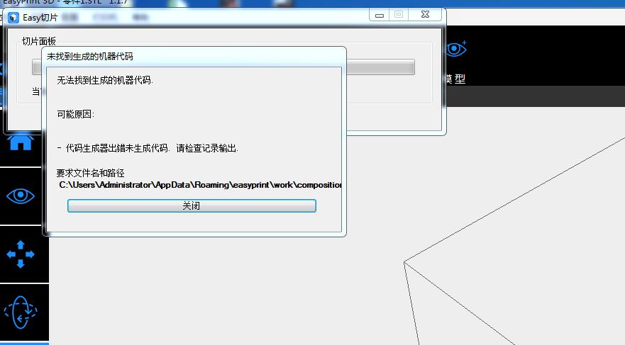

Post by jhhill3dprinter »
I had a problem with the updated version of 1.1.7. not slicing and giving me messages about not finding a gcode reference from my desk top icon. I went back to my 'all programs' list and clicked on my new Easyprint3d 1.1.7 version in that list. This opened up the application and then I tried it and it worked fine. This new version then started working fine on slicing from my desk top icon. It must have corrected the error in the app.
