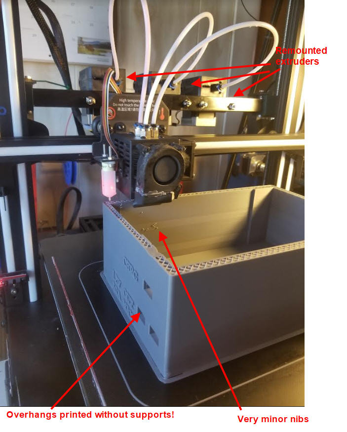

I stuck with the recommended Cura slicer for the A30T and used the Geeetech Facebook group and this forum to help me get up to speed on this platform using the recommended slicer. What I found was this platform has a much steeper learning curve than my I3 Pro. Stringing and plate adhesion were the two biggest issues for me to overcome. The adhesion issue was overcome by using hair spray much as I had been doing with my I3 Pro. I did purchase the Geeetech “super plate” with the printer but honestly this seemed like eggs on the Teflon frying pan; filament did not stick! I used hair spray on the super plate and then all was good. Using hair spray on the stock plastic build plate would probably do just as well as the super plate. After a year of using the super plate I’ve found only a small amount of hair spray is required on the super plate to help with adhesion, in fact I only spray on the plate perhaps once every 10 or so prints.
The stringing issue with the printer was not as easily solved. Not getting good results from the Cura slicer, even with all the great inputs from Bruce Greenleaf via the Facebook group, I decided to split from Cura and give Prusaslicer a try. After a month using Prusaslicer, my print results were improving. While not quite up to the I3 Pro, printing results were getting better. The Prusaslicer forum and help files were so much better than Cura and questions raised on the Prusaslicer forum were answered very quickly. I was sold; Prusaslicer is a superior slicing engine for use with the A30T. On top of being a great slicing machine, the tool is free!
I was still getting minor stringing hairs on prints even while using Prusaslicer but much reduced from Cura slicing. So I scoured the internet looking for solutions and eventually I found an A30T user on Thingiverse that came up with a solution to reduce stringing. It seems the stock Bowden tubes lengths don’t transfer all the retraction/detraction movement set in the slicer to the filament(with any Bowden tube 3D printer you have to have a little pull back of the filament prior to nozzle movement to another area to prevent oozing which is the cause of stringing). In fact you can see this on the stock printer, the Bowden tubes move when the extruders retract and push back the filament, which transfers to less filament movement than intended. The solution is to shorten the Bowden tubes which means you have to move the extruders. I made the necessary modifications to my A30T printer to implement this change and stringing is now virtually eliminated. I also added angled supports for the Z-axis (a 420mm long Z-axis will wobble ever so slightly during large vertical printing so adding this brace eliminates this issue).

Support settings I use PrusaSlicer spray on supports. Works really well where you can print 90 degree overhangs perfectly. I just created threaded slots at 90 degrees to the build plate and they work perfectly. I have attached two snapshots of my PrusaSlicer settings. I am using 2.4.1 currently.
