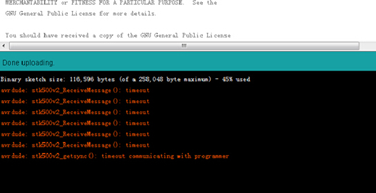

1.timeout error
avrdude: stk500v2_ReceiveMessage(): timeout
avrdude: stk500v2_getsync(): timeout communicating with programmer

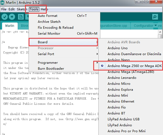

1.1Check the board type and COM port. You should select the correct board type here(example: GT2560): 1.2 Unplug all the other parts on the board except the USB cable, then try to upload it again, sometimes the I/O pins will be occupied by the other parts.

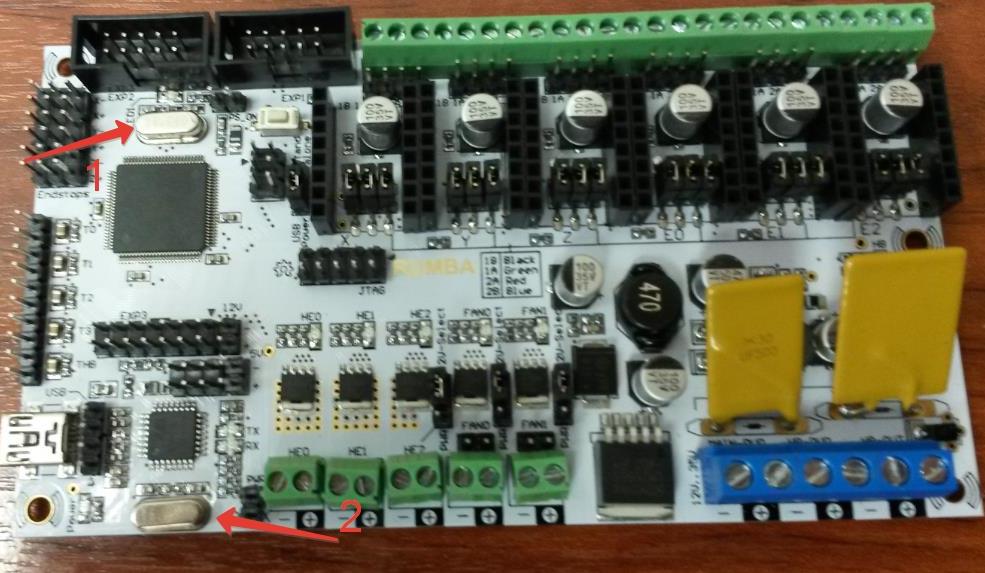

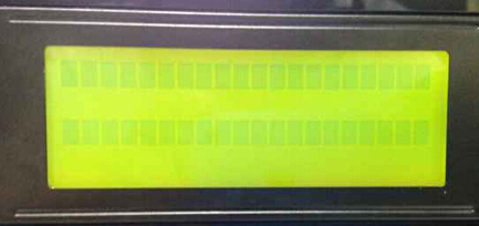

1.3 Check the crystal oscillator, see if there's bad contact or not, you can try to resolder it. I have test it with my board, remove it and it will get the timeout error. And the LCD will show two blocks when it is removed. The crystal oscillator might be damaged during the transportation or have empty solder.

Choose board type arduino mega, and the correct COM port. Have tried different versions of arduino and windows, mac OS, the same result.

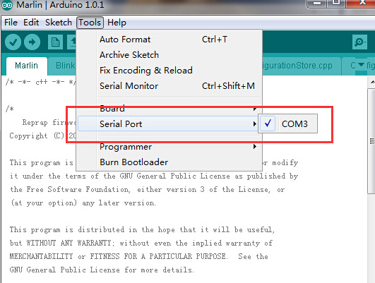

3. "COM port already in use"
If you run into this error when compling, this means your COM port is occupied by some unknown softwares, you can try the following ways:
1. Since you didn't know which software is using the COM port, so we can use another way to connect to the COM port and disconnect it to unlock the COM port.
In most circumstances, you can open the repetier host, click “connect" to connect the printer, after the button turned green and then disconnect it agian, the COM port will be free now and you can try to reupload the firmware again.

On my Board (rumba) two crystals. Which one to check? What to do with the warranty when soldering? Bought at aliexpress.
