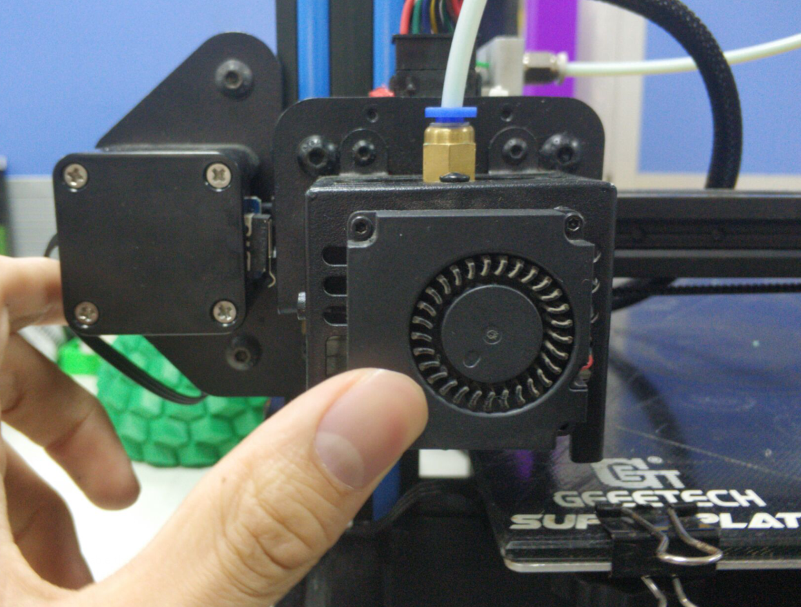

2. Move the hotend to X0 point(If you don't do it, the nozzle may hit the heat bed)

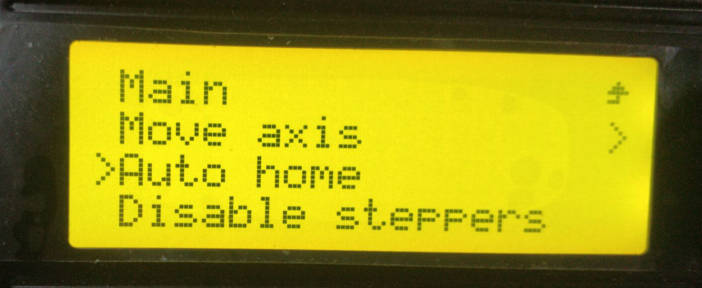

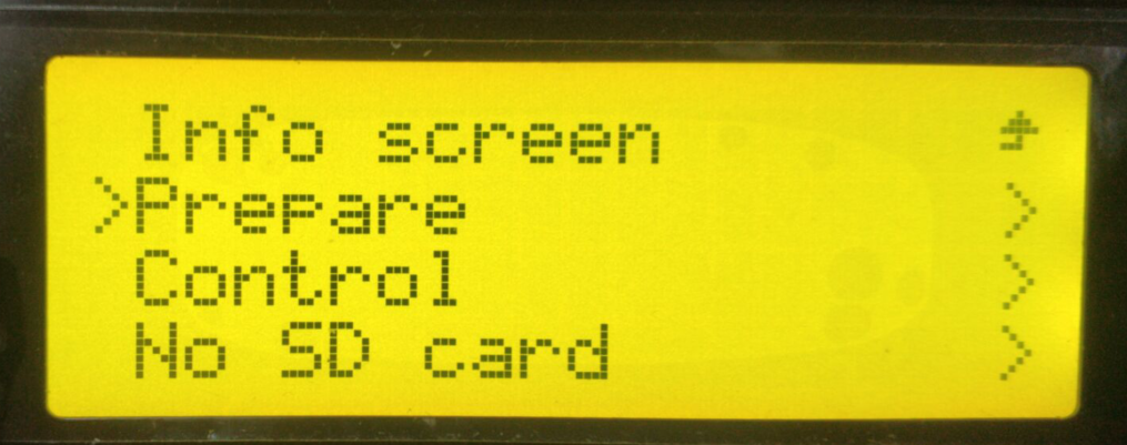

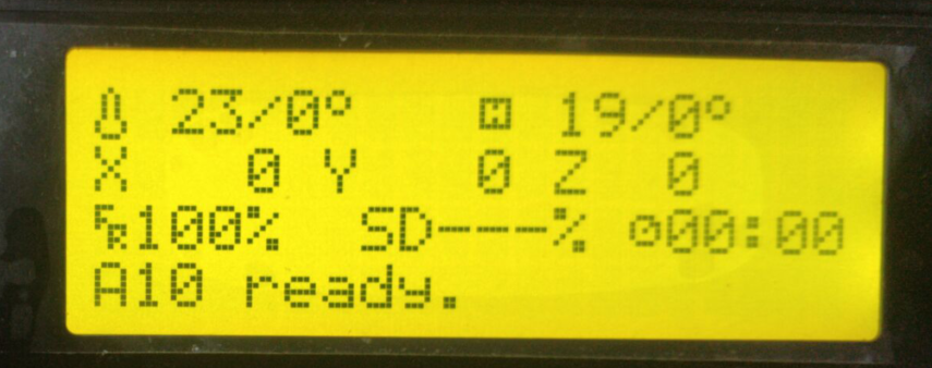

3. Click the LCD bottom then select"Prepare">"Auto home"

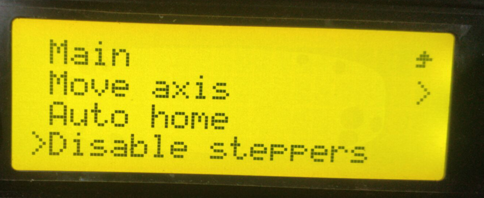

4.1) Then you need to disable the stepper motor.
2)LCD>"Prepare">"Disable steppers"

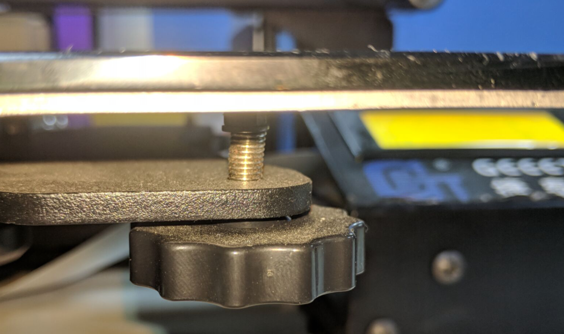

5. Tight the print platform adjustable screws at max

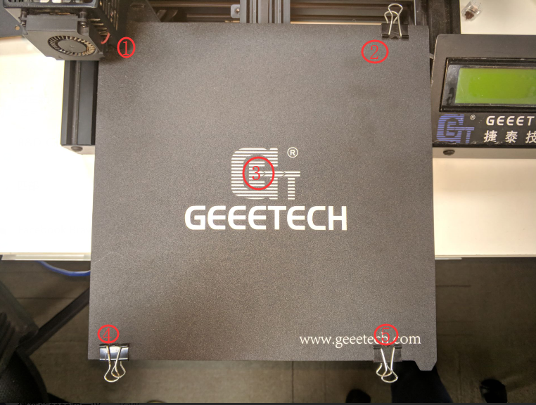

6. You need to move the hotend and find the lowest point of the print platform(5 Points)
7.1)You need to prepare an A4 paper
2)Move the hotend to the lowest point,
Put an A4 paper between the nozzle and the print platform
Adjust the adjustable screw until the nozzle hit the A4 paper
When you pull A4 paper, if your hand feels a little of resistance and the paper hard to move. It means this point level finished.

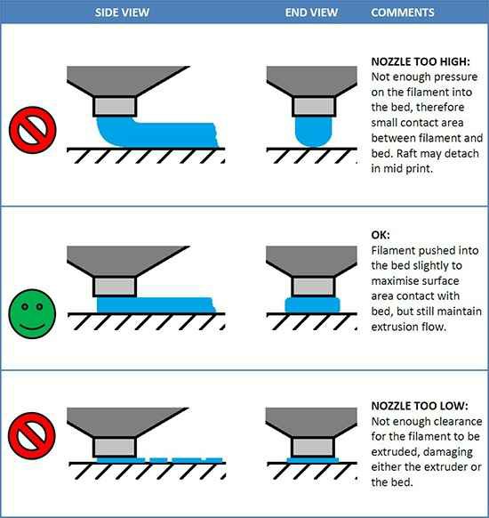

Refer to the picture below to check if the leveling is correct.
8.Refer to the step of NO.7 level other 4 points
