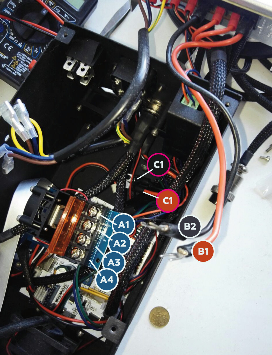

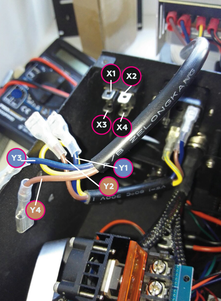

But now appeared new problem. I've lost my photos, that I made before dismounted part. I'm not an engeneer, and have not services near. Could you please help me? I made photos (attached) and mark all wires, that needed to mount. Like that "B2+A1" "C1+A1". Hope, you could help me.

Re: Cant assemble block after receiving part
Hi,the Y1-X2
Y2-X1
Y3-X4
Y4-X3
And B1-A4
B2-A1
C1(red -A3
black-A2)
I hope this can help you.
It work like a charm!
