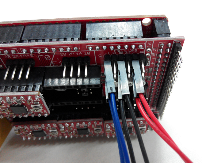

Firstly, you have to confirm whether the endstops are connected correctly.
If you want the firmware ,please leave your email address, after we send you the firmware, we will delete your email address in your post.

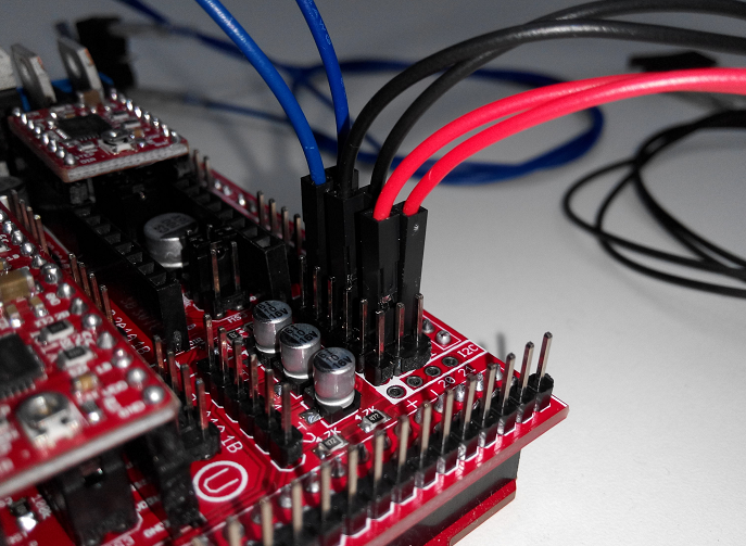

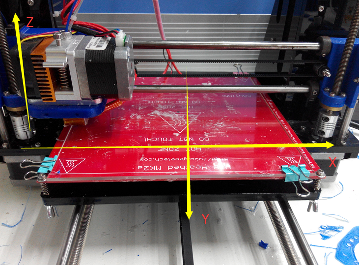

First confusion. Left to right should be X Y Z?
blue wire x extruder assy
Red wire Y plate assy
Black Z vertical axis
PDF for ramps is wrong pic btw shows connector side to side
I have firmware for i3b I found here working. Trying to adjust extruder height and speed now.
When using repeater there were no EEPROM setting showing so I wanted configuration file.
Ramps on site doesn't seem to be configured for display.
Please email me firmware to joellog@aol.com for comparison.
Thank You for your help

joellog wrote:Good morning,
3D printer is a DIY product. Not all the firmwares are the same. We have our own settings according to our design. So the firmware you download from internet is not necessarily exactly correct.
Please check your email.
