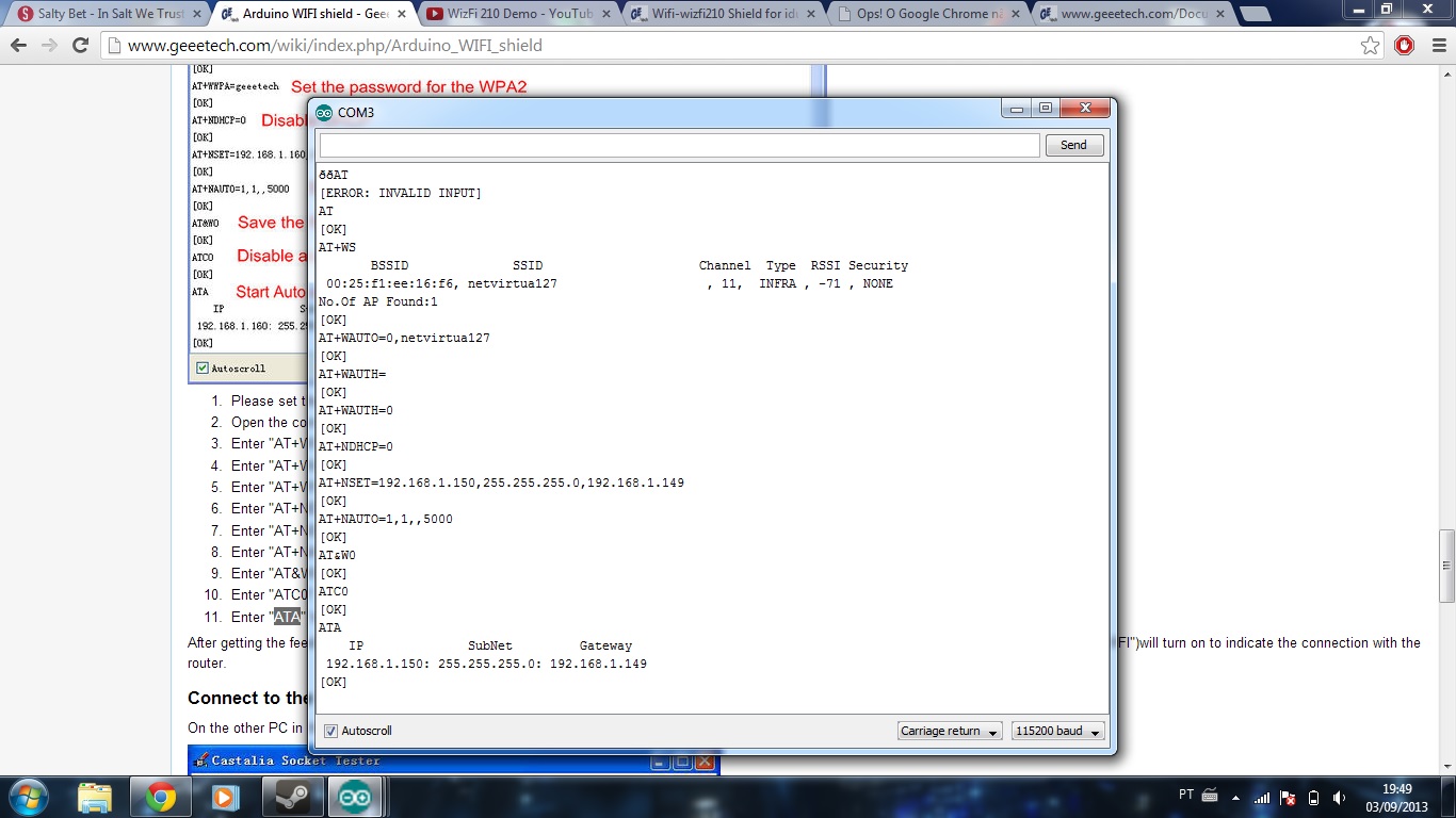

Re: WizFi210 and HTTP server Code
ok now i understand the wiki.
For Http server i can use the wifi.h from the arduino or i need a .h from geeetech page?
And the AT Commands for http server. I don't get it if i need configure for http server. Like port(80).
