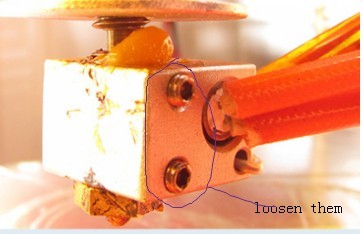

1.heating the hotend
2.Release the screws in your hotend
3.Unscrew your hotend and clean up your abs(keep heating)
4.Tighten the hotend
5.Tighten the Release the screws
now you can enjoy printing

The upper screw‘s function is choke,the other one is Fixed Laying head

you don't need to clean the hot end each 1-2printings,the problem isthat the choke is not tightened
