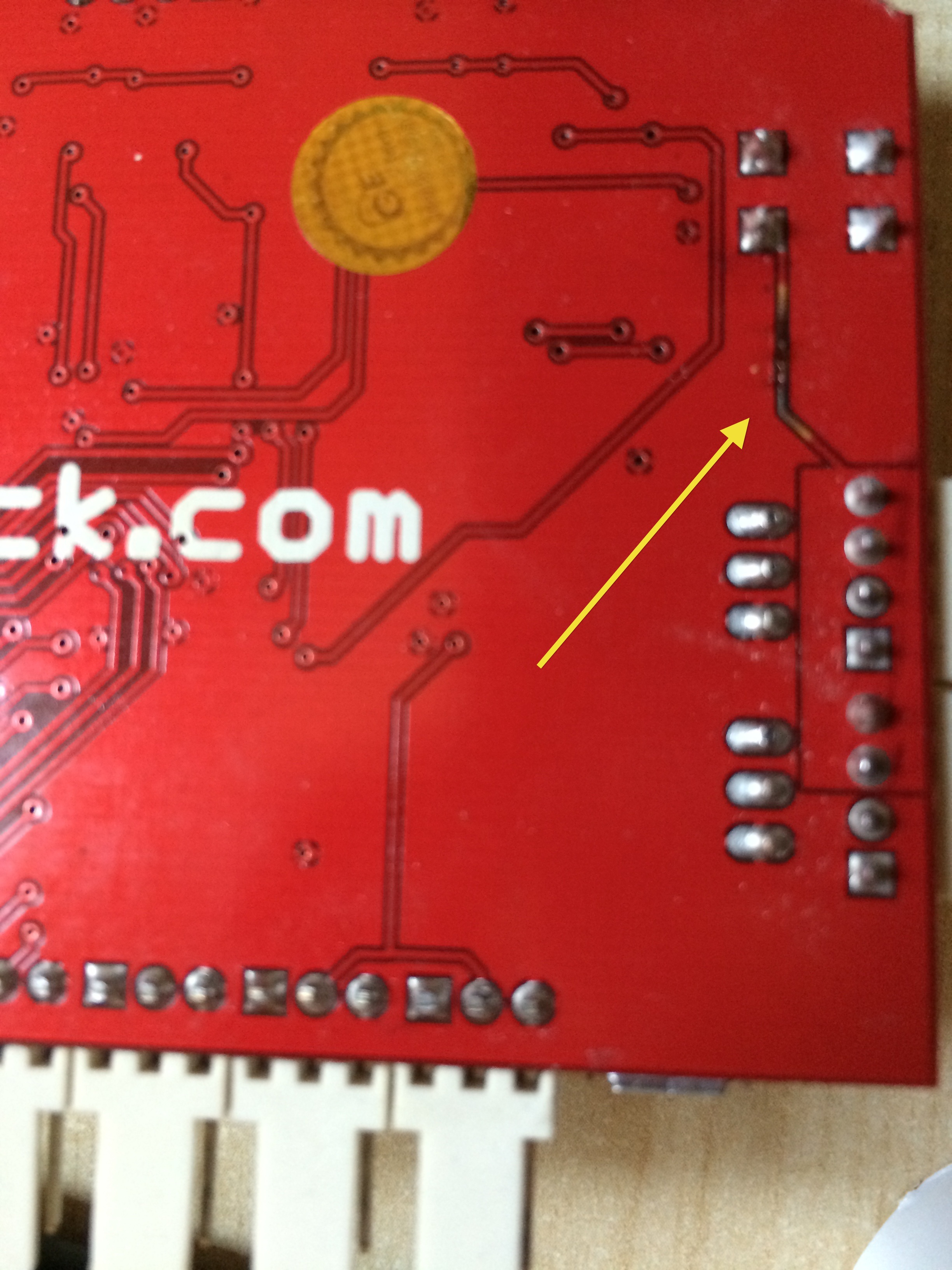

The first time I used it, the channel connecting power to mosfet burnt within the first 5 seconds. The board is now junk. I read on some forums that a lot of people had that problem and you have redesigned the new boards not to do that. I would like to get a replacement for my faulty board. I attached a picture of the board with an arrow pointing to the problem. Thank you.

Everything was connected correctly. I tested polarity with a multimeter. I was able to connect with USB and move the motors with no problem. As soon as I turn on power to the hotbed and hot end, it started to heat up but then I smelled burning and it stopped heating up. I unplugged everything and the board was burnt like I showed in the picture. No impurity or dust could have gotten into the board because it remained in it's original packaging until last week.

Even your own website has reviews that talk about this problem: http://www.geeetech.com/new-version-rep ... p-653.html ---> "Purchased 4 of these and already burnt 3 because the trace wire from the supply to the hotend/hotbed couldn't handle the current"
