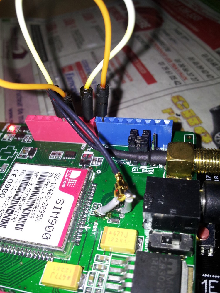

My shield is working now !
The antenna connector was not soldered properly. I made some soldering work on my shield and it works now ! :) I am registered to the network and I can send/receive some SMS.
Here is the problem !
See the picture included in this message.
kleofr
Posts: 2
Joined: Mon Nov 17, 2014 3:55 am
Re: SIM900 - No registration to network
Post by kleofr »
Hi !
What exactly did you do to fix the problem? Am having the same problem.
Thanks
hotkebab99
Posts: 15
Joined: Tue Jun 24, 2014 12:53 am
Post by hotkebab99 »
Hi.
To solve the problem, I unsoldered on the antenna socket. Quite difficult but possible.
After, I soldered 2 wires : one on the SIM900 pin and the other on the PCB where the antenna was (on one side of the socket).
Next, I soldered these wire to the antenna cable : the SIM900 pin to the interior and the other to the exterior. Look at the picture just before !
I hope it will help you !
