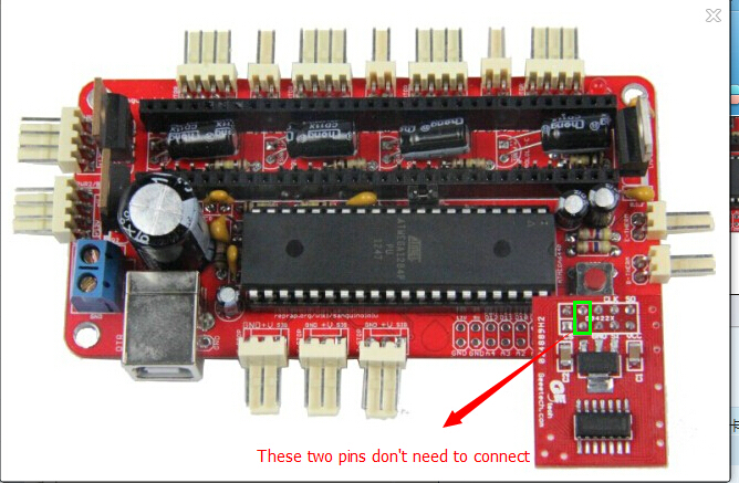

Second question is: The SD card shield don't match the pins on the board.. I looked at the wiring schematic and its hard to see if i'm supposed to put it on the last 6 pins and the first 2 next pins?? i notice if i do that there would be 2 pins missing between the first 6 pins and the last 2 pins of the shield. Can you confirm this? or am i wrong?? Also is the SD card shield really needed for the printer to work or can i leave it off??

3.SD card module is the right connection, the two pins you said don't need to connect, attached is the picture(SD card) for you reference, please kindly check it.

Thank you for your reply, the picture was very helpful and i got the SD shield installed.

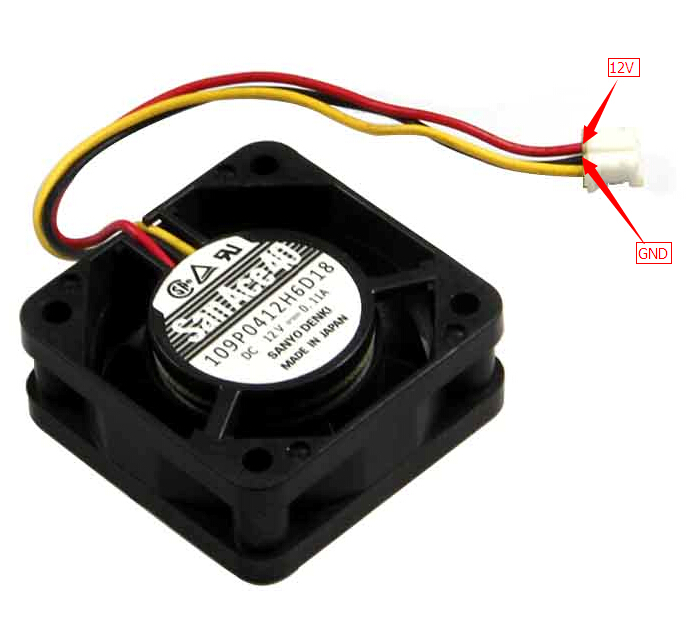

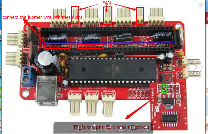

Question one: Where do i connect the fan? the instructions pdf don't say where to connect the fan.

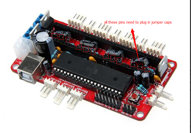

Question two: About the Marlin firmware you attached here. do i have to install that? i thought the firmware was already pre-installed? I was able to communicate with the printer from my laptop using the Virtual Com Port USB drivers suggested on your Sanguinololu page here http://www.geeetech.com/wiki/index.php/Sanguinololu (step 1 under firmware download). After i installed that driver i used pronterface and it connected to the printer, i was able to control all the stepper motors and turn on the heat bed and the hotend. i just had one issue, the stepper motors acted like they were not getting enough power to correctly move the sleds. how do i adjust so that the stepper motors get the proper voltage so they can correctly move the sleds (X,Y,Z axis and the extruder)?

1. Attached is the picture to show you where you can connect with fan, please kindly check it.
2. To make sure motor can work problem, you should make these part correctly. Frist, make sure the jumper wire have connect with the pin as I show you in the attachment.

Thank you for your response.
I don't understand what you mean by this "To make sure motor can work problem, you should make these part correctly. Frist, make sure the jumper wire have connect with the pin as I show you in the attachment."
i have to have all those pins with jumpers??? all together?? i don't understand what you mean there, can you please clarify what you mean

Dear Ben,
Sorry for my poor English.
Yes, the pins I mark for you as the attachment need to plug jumper caps.

Thank you for you help, those jumper caps fixed the problem!

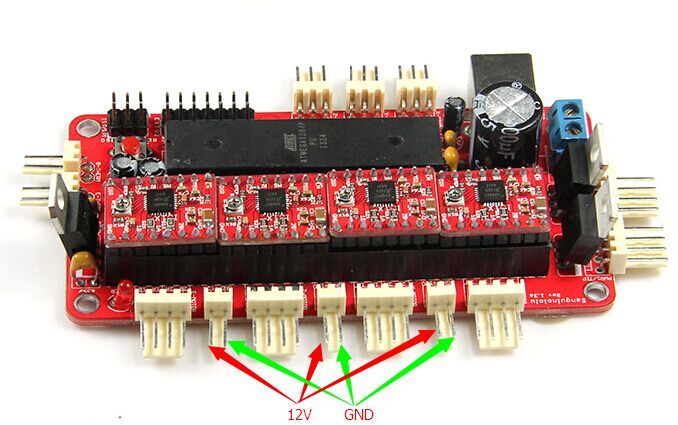

Question two: About the fan, the fan plug has 3 wires but the board only has two pins for the fan.
How do i plug in the 3 wire fan plug to the two pins on the board?

2. You only need to pulg 2 wire( black and red wires) fan plug to the two pins on the board. Attached is the pictures for your reference, please kindly check it.
