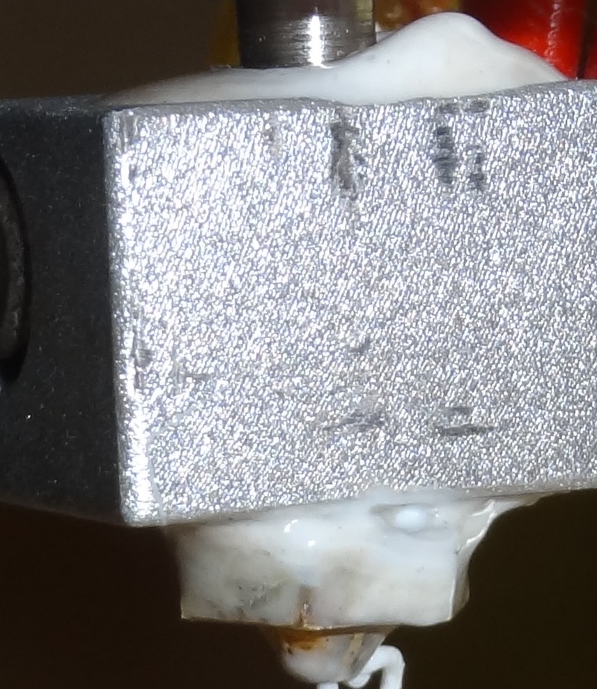

I just finished building my prusa printer (I was helped by a friend which builded 3 3D printers) and I faced an issue with the J-head : some molten filament leaves on top of the heating component and also between the nozzle and the heating component.
Now, I really need to have my 3D printer working but this seems to be an insoluble issue.

J-head leak
- J-head leak
- Head.jpg (295.65 KiB) Viewed 8350 times

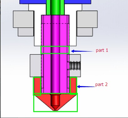

Re: J-head leak
I'm sorry to appear this kind of phenomenon, I checked photos carefully your provide.
I think the hotend leak a lot Maybe due to no tightening between 1 and 2, Refer to the attached figure.
so I suggest you clean up the leak, tightening between 1 and 2, Then, I think it will work perfectly.
you can try it again, thank you, Best regards!
- jichuji.jpg (24.35 KiB) Viewed 8313 times

Re: J-head leak
Thanks for your reply.
I have made several tests, however it appears that, although when the head is cold it is possible to tight correctly, as soon as the head has a 200 C temperature, the nozzle is like "free", and a space appears between the nozzle where the hot filament is "expulsed"...
So it can't print correctly as this additionally filament fall down on the print...
Any other idea ?
Thanks
Jean Jesuis
Any other idea ?
Thanks
Jean Jesuis
Re: J-head leak
dear friend:
sorry to hear that,you can use Sealing grease or screw thread to tight the hotend up。
