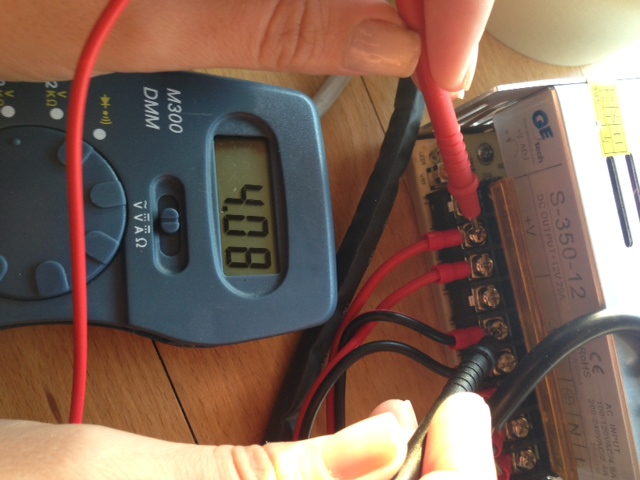

Hello I have a problem with the power supply that I bought with the Delta Kit.
The problem seems to be that the power supply is not allways at 12 Volts.
When I turn it on, without the USB connected it is at 2.83V. Here comes the first problem as the LCD screen does not have enough power to run, maybe the whole system cannot run.
When I connect the USB, the power goes up to 4.09V. The LCD works, I can connect to the printer but it does not move nor heats.
Sometimes the power just goes up to 12V and everything seems to work excepts that when the hotend is about to reach the temperature, the power supply turns off and goes back to 2.83V again. So everithing stops working forever.
I don't know what to do. I could post images of the whole process if this is not clear.

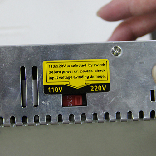

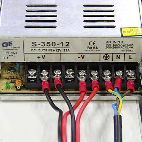

dear friend:
first,i want to know that what is your power net,110v or 220v?if it's 110v,you should make sure that you put the switch to 110v
i want to know the way of your power connection.PLS check your connection。
The brown line is zero line。
The blue line is FireWire line。
The yellow&green line is ground line。
The red(v+) is 12v,the black(v-) is gnd。
if the problem is still existed,PLS take some pictures for us。

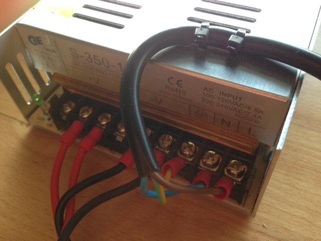

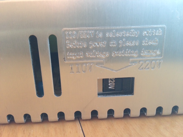

Hello,
Thank you for your response, the power net is 220.
It seems everything is connected alright, you can see the photos here. (Red cable is positive and black is negative as you said but I think your connection is wrong)
la foto 1.JPG (103.37 KiB) Viewed 9880 times
la foto 2.JPG (90.63 KiB) Viewed 9880 times
la foto 3.JPG (94.1 KiB) Viewed 9880 times
The screen is off and it only turns on when I connect the USB but the voltage in the font is still 4~ V

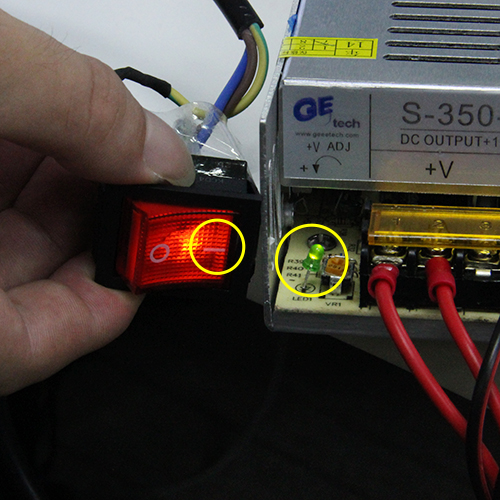

HI paurosello :
first you make sure the power suply don't conect with board 。i want to kwon that do you turn the red buton to “—”?and the green led is light?
