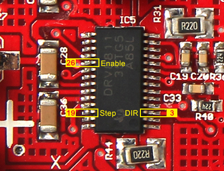

hi s10blazed:
1.you can check these signals with Oscilloscope.
enable 0v
dir 0v-5v
step 0v-2.5v
2.if these signals are ok,then maybe the chip drv8811 is broken.
if not then the mcu or the wiring is broken。

Thank you for posting the image. I do not have an oscilloscope to verify the pins. I have swapped stepper motors to confirm it is not the wiring of my printer. Whether it is the stepper driver or the MCU, wouldn't a replacement board be in order since the gen6 is one piece?
