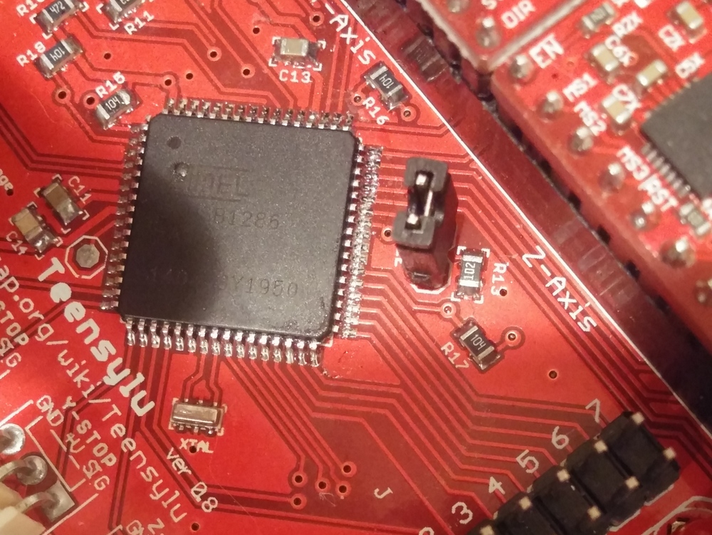

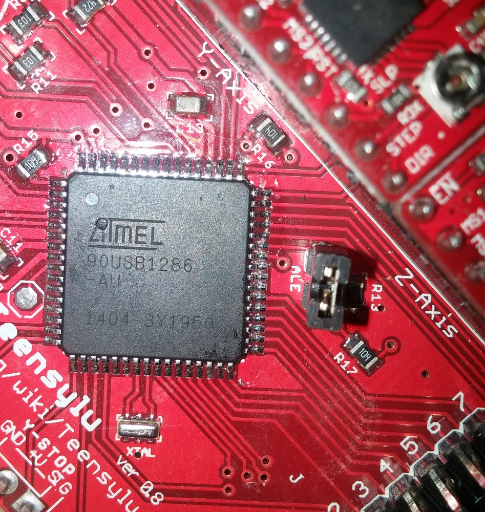

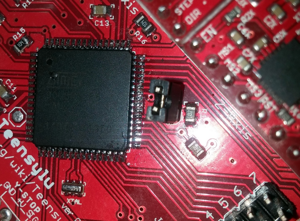

The soldering on the board is ok except for the microprocessor. The soldering of pins on the programming jumper side looks bad, as do some of the pins on that corner and the side nearest the stepper drivers. I am including pictures.
Please advise ASAP how to rectify this. Here are pictures:

- Processor side nearest programming jumper shows bad solder.
- 2015-01-018.jpg (360.46 KiB) Viewed 13549 times
- Another view of processor pins solder
- 2015-01-017.jpg (623.33 KiB) Viewed 13549 times
- Close up of the Teensylu processor. Solder on pins not clean/good
- 2015-01-016.jpg (448.51 KiB) Viewed 13549 times
Re: Y axis not working on Teensylu
Dear friend,
Sorry for delaying your valuable time. If you have the tools, you can try to re-welded those pins. Our cutomer service have already contacted you and gave you solution, please kindly check you email account.

The suggestion of soldering the processor pins worked and the Y axis is now functioning. I had purchased another Teensylu from you in case this one didn't make it, so now I have both working, except for the hot end.
