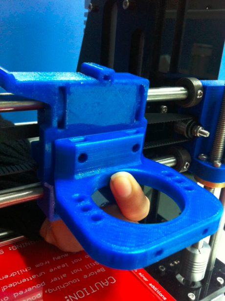

I have received what appears to be the wrong 'P6' Print bracket.
There are no holes on the top or bottom to mount the extruder, and it looks very different than what is in the wiki.
Any suggestions?

I am sorry that we did not update the picture in the wiki timely. Actually, we remove the holes on the bottom, leaving 2 holes in the middle for a firmer mounting. So you just mount the exturder platform to the 2 holes. I apologize again for your trouble and our careless work.

I do not understand how to attach it. If I attach it in the middle, there is no way it can actually touch the build surface, the extruder is not low enough. Do you have a picture of the complete assembly? Another problem I had is that I did not get nearly enough square 3mm nuts, I will have to improvise.

The correct attachment is shown in the picture. If you still have any problem, just send a message and I will reply you timely. Thank you.
