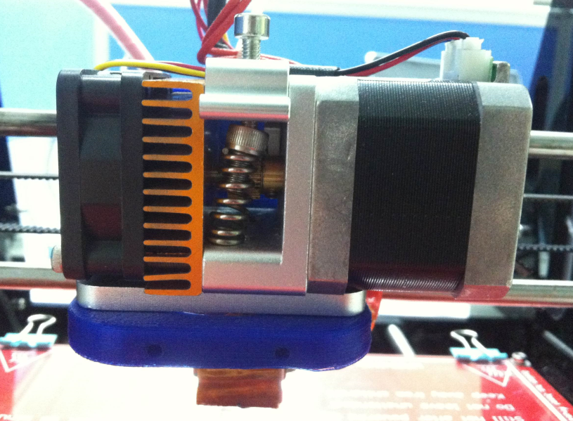

This image from the assembly guide does not show clearly how to fix the M4 nuts:
I wish someone post a picture taken from a different angle of this image as it seems there is no spacing between the blue support part and the aluminum plate:
Appreciate your help.

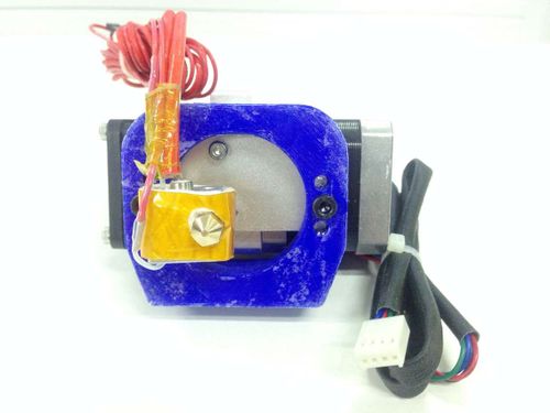

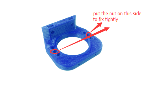

Is this picture clear?
abulafi
Posts: 15
Joined: Tue Mar 17, 2015 12:34 pm
Re: Mounting the MK8 extruder in Acrylic I3 pro B
Post by abulafi »
The picture is clear but it seems that there are no M4 nuts between the aluminum plate and the blue support part, right?
zhangxueyou
Posts: 1405
Post by zhangxueyou »
I am so sorry that we updated the extruder bracket but we did not update our wiki because of our careless job.
The type of the screw is M4 X12.
Sorry again for wasting your time.
