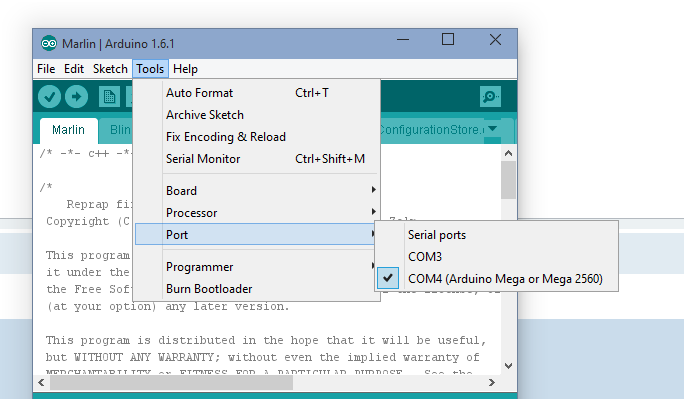

zhangxueyou, thanks for trying to help me!
I have chosen the correct board. As for the port, when I plug in the USB cord and connect the ATmega it automatically chooses the COM4. I can't change it to 'Serial Ports'.

I had bought a second ATmega 2560 board to see if the one I got from GEtech is defective or not. The new board arrived and it gave me the same problem. That meant that the problem is my computer and not the boards. My main computer runs with Windows 10 tech preview. I have an old computer with Windows XP. I tried both board on it and it loaded the sketch to both of them fine. They are both now running with no problem.
Problem Solved!
