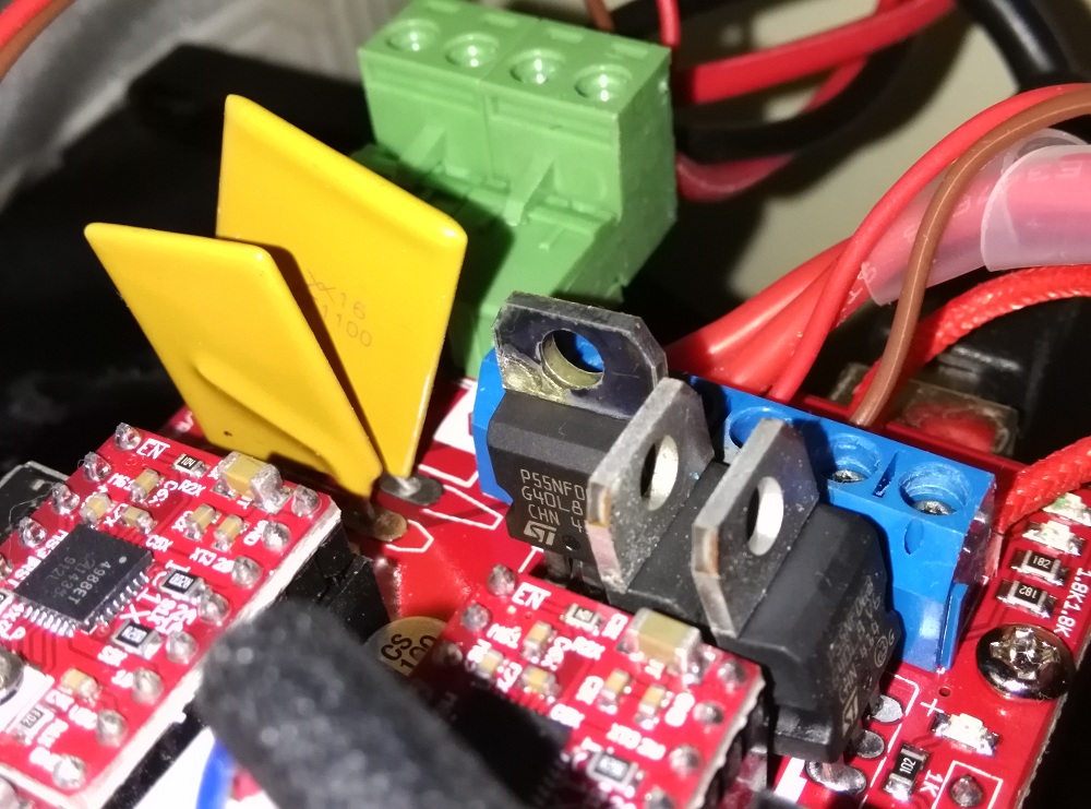

When I turned the power on again, without out it being connected to the computer, I saw the red LED for the heatbed come on and the temperature displayed on the LCD starts to go up. The temperature for the MOSFET also started rises rapidly and I could smell burning electronics again.
I can see that there is heat fatigue on the MOSFET. picture attached.

- MOSFET showing heat fatigue. Different colour from the other 2 MOSFETs
- RAMPS_mosfet.jpg (265.53 KiB) Viewed 14467 times

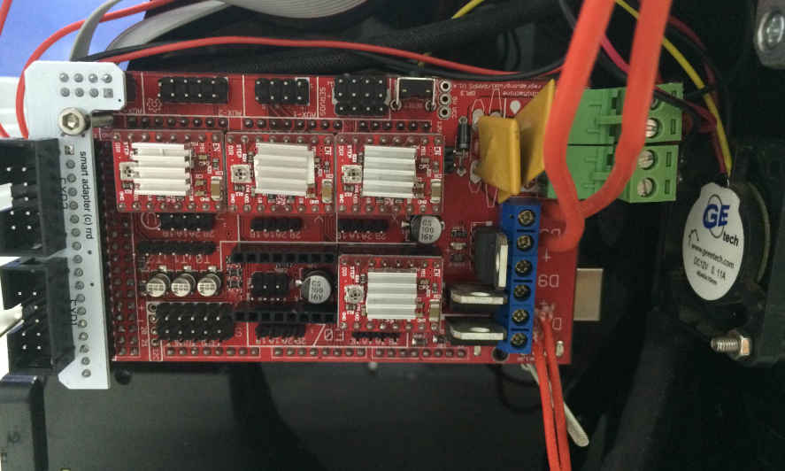

Re: RAMPS board smoking
The fan beside the mainboard is used to cool down the MOSFET. You reverse the mainboard and the wind is blocked by LDC connectors. That will influence the MOSFET to cool down.

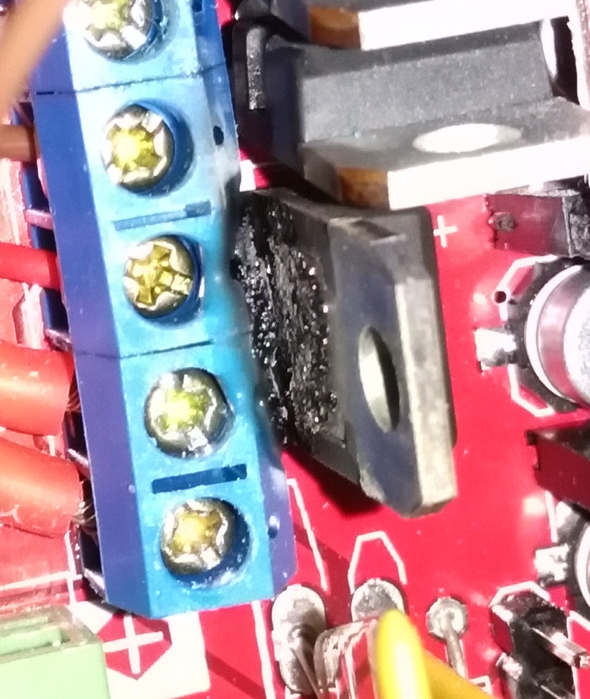

Here is a photo of the other side of the MOSFET. It has melted and burnt the plastic.
The thermal fuses on this board do not work.

- RAMPS D8 and D9 connector burnt
- RAMPS burnt.jpg (268.23 KiB) Viewed 14454 times
The mainboard should be mounted on acrylic board like this picture, so that the fan can cool the MOSFET down.
