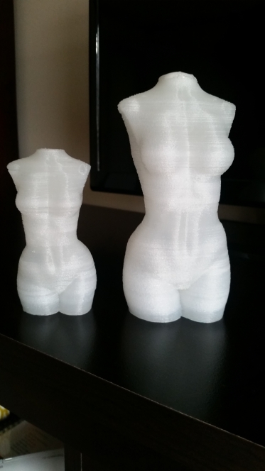

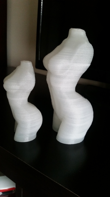

I liked the girl you printed and decided to print one myself. My settings overall are different than yours (I am using mattercontrol for my 3D printing software and a wider nozzle [long story to how I ended up with a wider nozzle]). However, no matter what size I printed, I did notice the line patterns was the same on both prints (they both became thicker in the same spots and thinner in the same spots). With that in mind, I guess it would be a slicer/layer height/filament issue (I have about 8 different filaments. PLA, ABS, and PETG. some do print better than others, even within the same group. One ABS color/maker prints better than another ABS color/maker). Try printing it bigger. The lines should become smaller. Also try changing your layer height too (one thing affects another so you may need to change your filament speed too because the height is smaller). I know you have tried some of these things already but try changing two things at a time and write down what you changed to keep track and see what happens. I know the trial and error idea sucks, but it works. I don't mind the lines on mine so much. I have seen worse on a cube X Duo and that is suppose to be plug and play/print!

email4walker
- Posts: 26
- Joined: Mon Mar 16, 2015 10:21 pm
Re: printing setting and fixing
Sorry, forgot to attach the pics:

Wow, your models look beautiful and smooth! Could you please share your settings for us? I will be appreciated.email4walker wrote:Sorry, forgot to attach the pics:

Sorry for the late reply. I am using MatterControl for my 3D printing software. The settings I changed was:
On the woman body: No infill/set to 0 (I did this because my nozzle was hitting the infill after it hardened and was messing up the layers. Since there is no infill, I put led lights on the inside so when you shake it, it lights up)
Perimeter Layers: 4
Turned on avoid crossing perimeters (helps remove oozing strings)
Number of top and bottom layers: 4
Perimeter print speed: 30/30%
Non printing travel speed: 50 (I lowered it because sometimes the quick move would shake the hot bed/model)
Extrusion Multiplier: 2 or 3 (3 worked best for me)
Important note: I drilled out my nozzle to 1.2mm/1/32 inches. This was a accident. My nozzle became clogged and I was trying to clean it out. I used a smaller drill bit and it broke inside the nozzle, so I had to use a bigger bit to drill out the broken bit. The mistake worked out great! No more clogging and no more clicking sound from the extrude motor.
The down side: I use 30% more filament now because the nozzle is bigger. I am not suggesting people drill out their nozzles. However, it did fix some of my issues. I still do get bad prints now and then.
Perimeter Layers: 4
