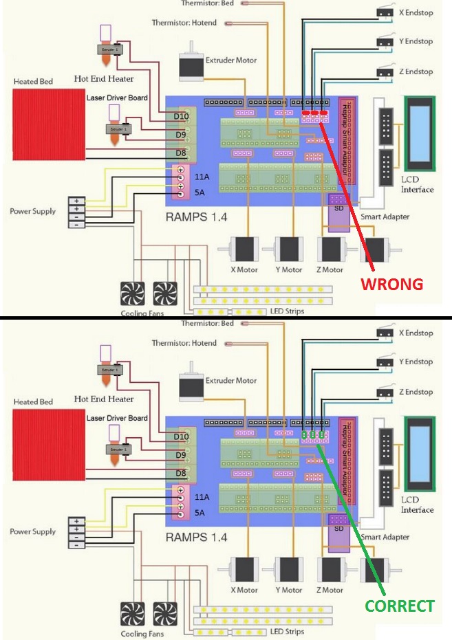

Re: All axis only move in positive direction
For Mega2560/RAMPS 1.4
I found a solution that immediately worked for me - The directions provided on the build instructions were inaccurate regarding the wiring of the end stops: end stops should be vertical (not horizontal)
**see attached pics (top picture shows jumpers marked in red, this is what I found in the instructions and will result in axis only operating in one direction) ~
(lower pic with jumpers marked in green is the correct pins and immediately corrected problem for me resulting in all axis would now move in both directions).
** NOTE: always turn off and disconnect all power and discharge any static by grounding yourself (touch a metal object that is grounded) before touching/working on your circuit board(s)
- end stop connections.jpg (169.41 KiB) Viewed 9830 times

Thank you for your carefulness. We noticed this problem recently, if you amplify the older picture, you can see which pin are circled. But because we highlighted it with a color which is not obvious enough, many of our customers connected wronly. We sincerely apologize for this. Now you don't have to worry you connect wrongly, because we've changed the color.kafarn wrote:For Mega2560/RAMPS 1.4
Thank you again.
