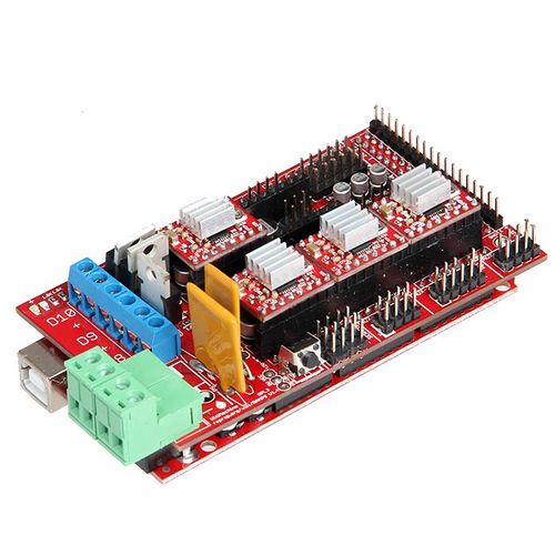

Ok I had placed the motor boards on backwards, I went by the picture in the wiki ramps manual. But I reversed them and they are moving. I havent got the mintemp error since I lowered the min temp to 0 in the firmware. Im pretty sure the z threaded rods are bent, I can see them wobble and its causing resistance in the movement. I also cant get the manual movement to go beyond about half the board each way the motors start to grind. Also the z end stop dosnt work even switching wires around.

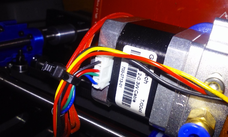

Here is a picture, I just tried to do a test print and the printer moved the extruder all the way down and tried to keep going probably due to the z end stop not working. I did get some filament to come out in a test which is good. In the picture you can see the wire layout is different than the end plugged into the board.

Re: My stepper motors wont move, any of them
That's no problem.
