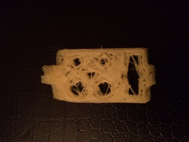

Khilborn
Posts: 18
Joined: Tue Apr 14, 2015 9:32 pm
Re: Bad Print Quality
Post by Khilborn »
After more calibration last night this is what we get now. The bottom 4-5 layers just are not right yet. We put the 1st layer height at .24mm which is 80% of the nozzle diameter and changed the heat for the hot end to 245 and the bed to 110. Any ideas on why these 1st 5 layers look like poo?
zhangxueyou
Posts: 1405
Post by zhangxueyou »
The distance between nozzle and hot bed is still not low enough. No gap between the lines of first layer is the best.
Zorce
Posts: 28
Joined: Wed Feb 11, 2015 12:21 pm
Post by Zorce »
Hmm not sure. 245 for the extruder seems pretty high. I keep mine about 205 and bed at 100 first layer and 95 the rest.
My theory from looking at it is there is too much heat between the extruder and bed causing a warp effect. If course when you go up in payers the heat between the extruder and bed is further apart and layers seem to do ok once it reaches the cooler point. I am just making an guess judging from your picture.

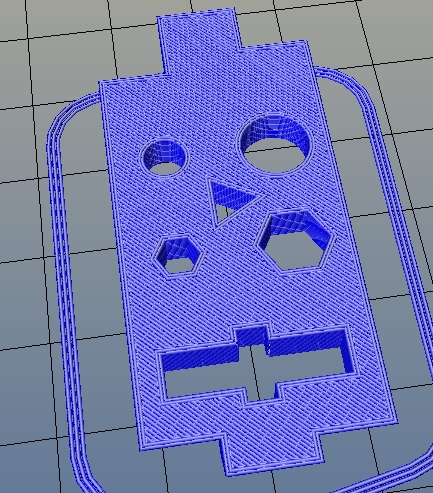

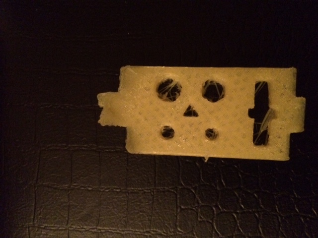

Posts: 18
Joined: Fri Apr 03, 2015 2:55 pm
Post by orest »
I am having a problem with the first couple of layers as well. I am using the Geeetech PLA and the temperatures of the extruder/bed were 210/85 for the first layer and 200/80 for the other layers. The extruder was about 0.25mm from the bed before heating. Clearly, the bottom is terrible, but the quality improves as we go up. What should I try next? The attached pictures show the expected object and the bottom and top layers.
