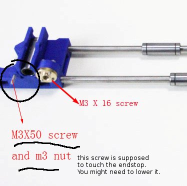

1. The z axis end point is too down that it cannot touch.

1. What do you mean by the Z axis end point ? I think you might be talking about your Z endstop. If that's the case, look after the screw setup on the X-axis left end (Part "P1"). You can lower it in order to touch the Z endstop sooner. Picture here :
