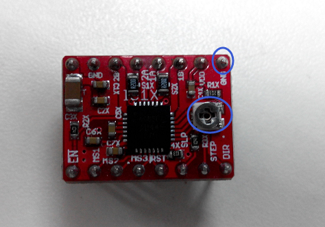

That's impossible, the max voltge between screw and gnd is around 1.5V. You must tested wrong.

Sorry, I can't see where you test the voltage. Are you pretty sure the voltage is tested between screw and GND? The maximum voltage is 1.5V normally.

obviously, this is where i measure....

Yes, I know what you mean. The voltage is referring voltage. The actual voltage can be much more than 1.5V.
